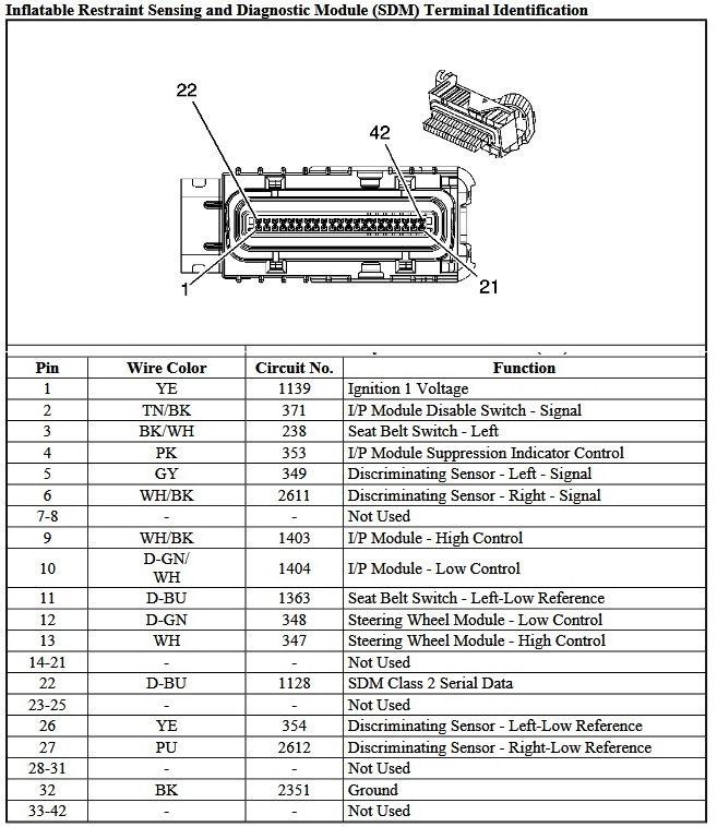

Hello all
Got home from a 3-month trip overseas last night and found my Airbag light is on the scanner says it is B1000 which is the ECU, the tech 2 says it part number 15172749 and a new part number
12231750
If I can find one of these does the dealer have to reprogram it also is this item where diagrams say it is under the driver's seat? I saw some places on the internet it states its in the engine compartment or under the center console.
Everything else on vehicle is working fine
Thanks

SDM is under drivers seat, check/clean connections/ check wiring first.

Thanks for the info seem to have found the culprit, there are three wires going to it they all seem to be pulled out, hower the connectors are still on there, I see silicone were PO owner must have tried to deal them in place, can anyone share a picture of there's so I can fix it, I need to know the color order of the wires into the module

Seems I have the wrong item the item the wires are out of is a cylindrical item on front of seat track

the module would be under thr drivers seat on the floor in a cut away on the carpet.

That sounds like you found one of the seat motors.....
The ECU is attached to the floor under the carpet. Not sure if you can get to it without removing the seat or not.
Old Feb 25, 2020 | 06:38 PM
Yes, E20 (front) & E14 (rear) sockets, disconnect connectors and remove seat.
