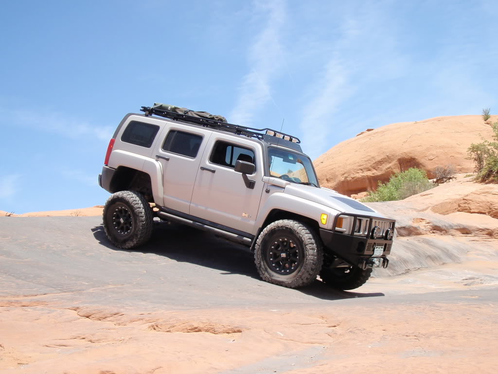

What you need: 17 x 9/ 5.71 back space/ +18 offset/ hub centric
Wheels I have fitted with 35's:
XD Addict
XD Hoss
You will need to order them in Hub Centric or get the Hub centric rings. 35's fit great and did not stick way out. They are a wider stance and slightly outward more, but not much. Since you are using 33's, you will have more than enough room at yur wheel wells and swaybar.
