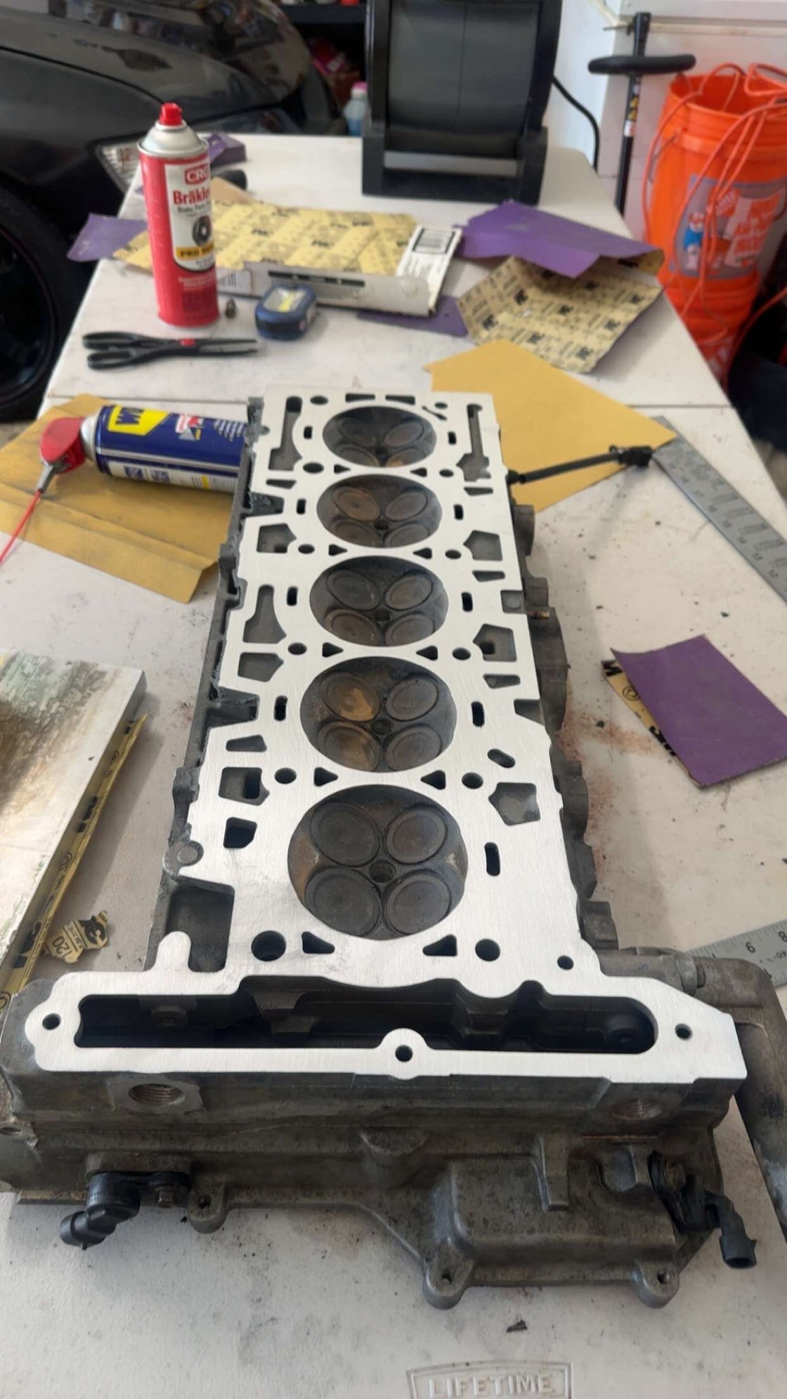

Originally Posted by NFS
yes but here is an update I took my cylinder head out and my head gasket looks toasted I can see residue of coolant all over and I even had coolant on my pistons . I stopped because it started raining . Tomorrow I am gonna sand it and check for flat surface and make everything is good and install the new one . I will also flush the radiator fluid and change engine oil as since it’s due . I also got a new thermostats just to be safe also

just finished sanding and checking for gaps and surface flatness . Tomorrow gonna put the new head gasket. Thats a pic of the old one. Gonna use carb cleaner to clean the head of the pistons they are so black

i am having a small struggle with the timing chain. Is there a way to remount it ? The tensioner putting all of tension on it and it only give me a little slack to mount. Any ideas how to put the timing chain back on the sprockets? I already marked it and all but that crap not mounting
