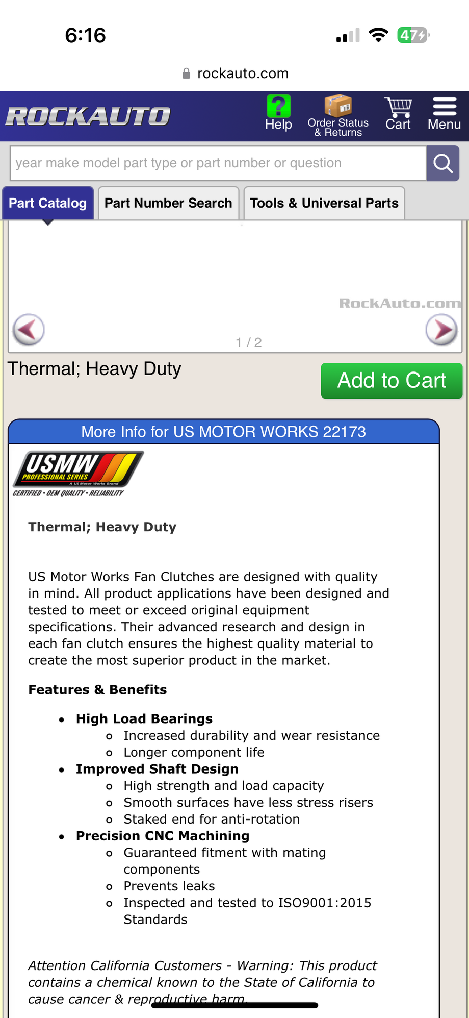

Also maybe a high output fan clutch assembly? Yes, I read that you replaced it but ...
thd one I replaced was the heavy duty one I think it’s high output??
is there a way to make the fan maybe run faster or is it one speed?
