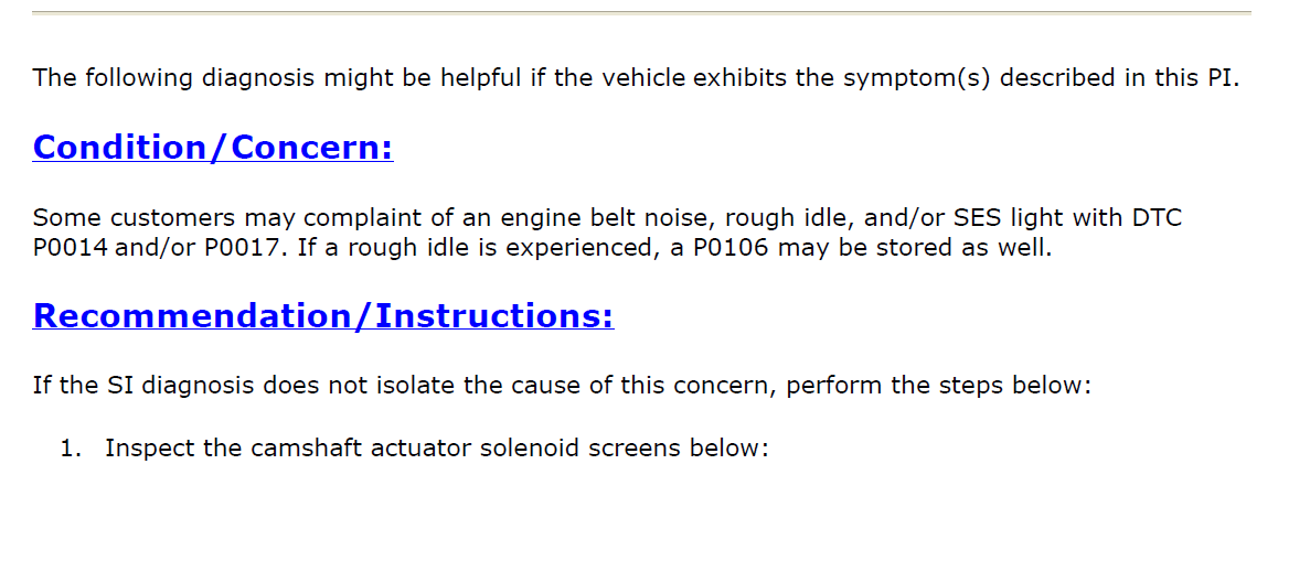

Your P0017 on GM vehicles means Crankshaft Position – Exhaust Camshaft Position Not Plausible.... means that the PCM believes the difference between the crankshaft position and the camshaft position exceeds 9 degrees after your engine enters closed loop = full operating temp and the PCM looks for O2 and Timing data (lots of other stuff too) from the sensors. Before that, in open loop it is running on its programmed default and apparently has no issue.

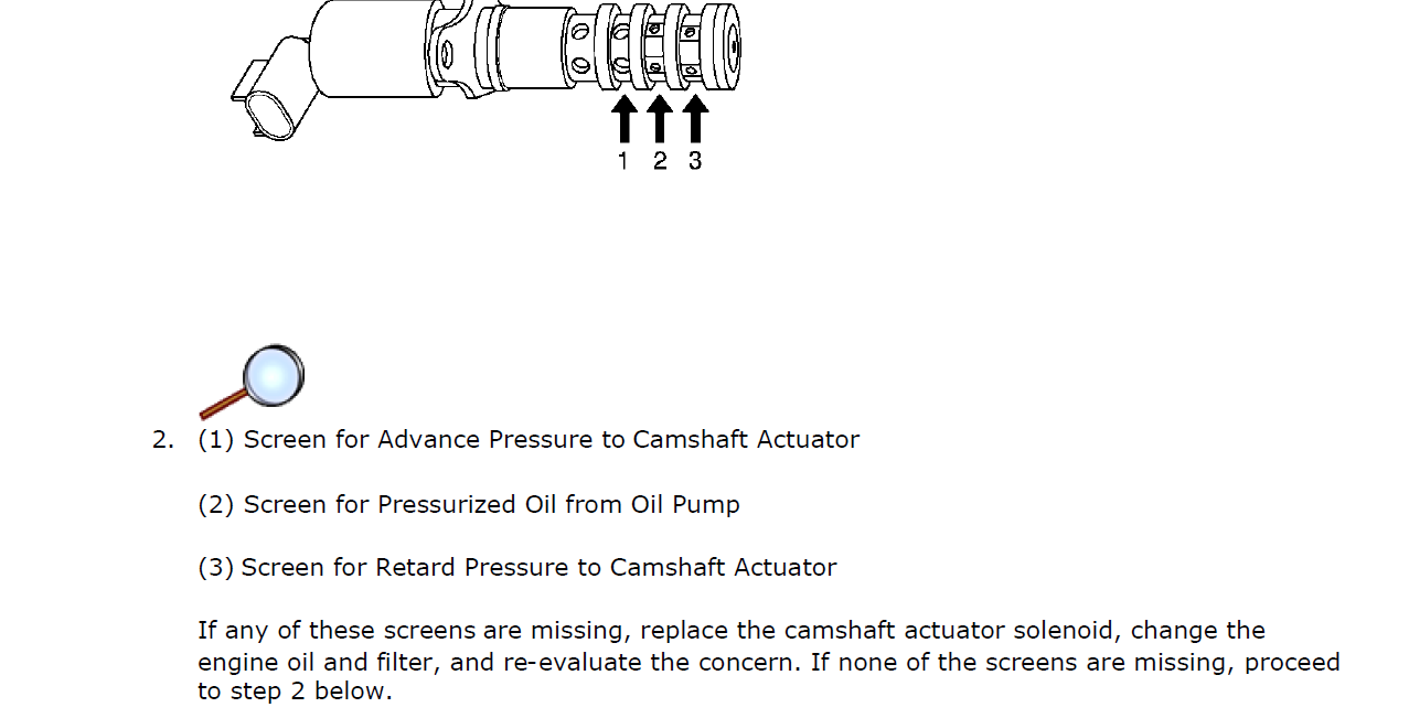

You could have a bad Camshaft Position Sensor, bad Crankshaft Position Sensor, bad Reluctor wheel, bad Camshaft Actuator Solenoid (which on the early H3s was known to get clogged with bits of the disintegrating oil screen and crud), worn/broken timing chain tensioners, improper timing (as in like when whoever put it back together), or just faulty wiring to the Cam or Crank Position sensors. I would assume that when the valve work was done, the tensioners were at least inspected?
I would do the easy stuff first, check wiring. Then pull the Camshaft Actuator Solenoid..... Followed by replacing the Camshaft Position Sensor, followed by the Crank Position sensor.
