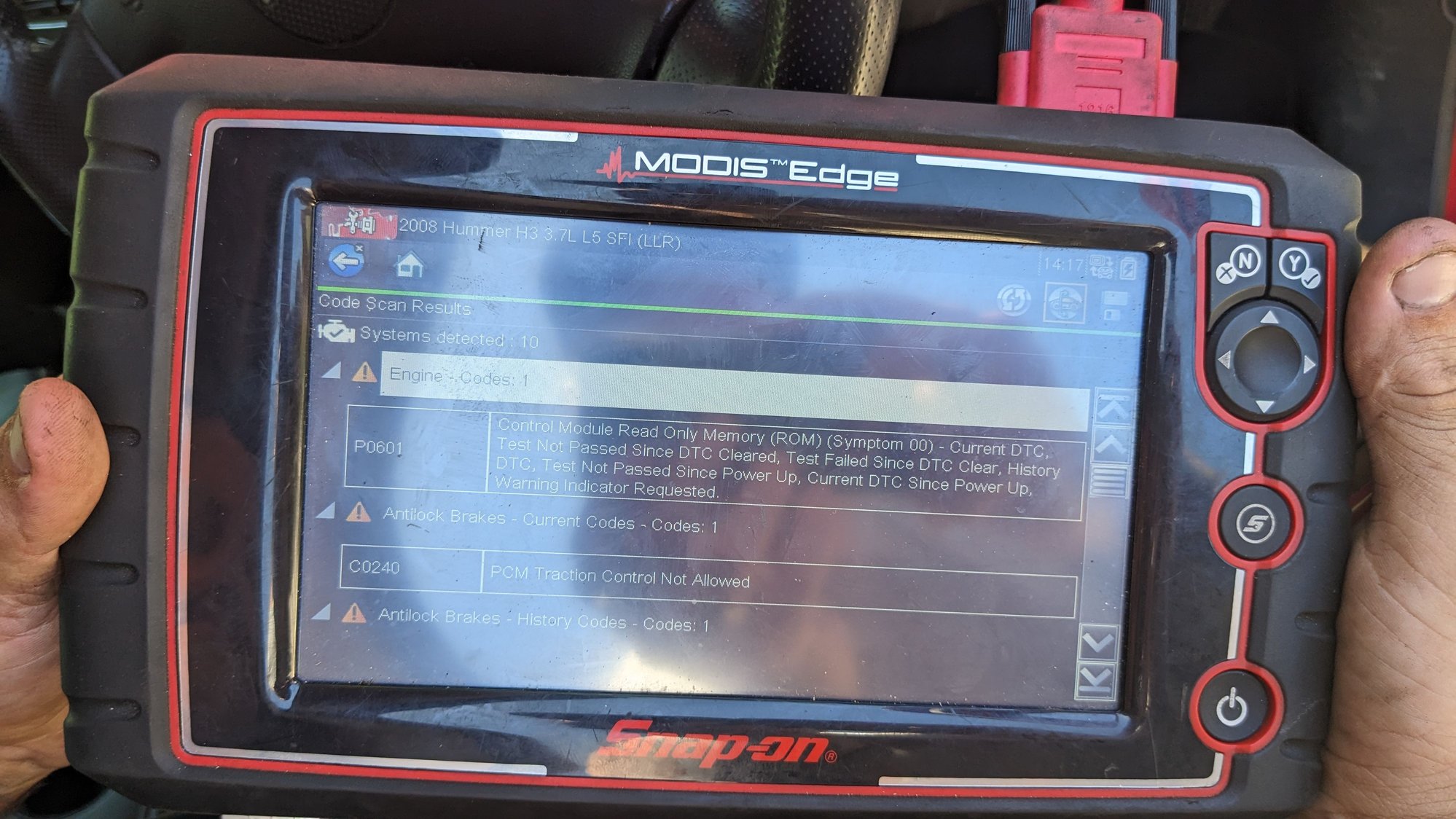

To quickly sum up, my car would completely shut down on hot days when at very low speeds or stopped and wouldn't restart until the engine bay cooled down. I would get P0601 error code when diagnosed, and the dash would flick through STAB SYS - TRACTION - FAILED - REDUCED - POWER - SERVICE with the check engine light on also. When the car would shut down it would just straight up stop dead. No sputtering, changes in RPM or anything. Just completely shut down as if I had switched it off with the key. When the car would restart, only the check engine light would be on, the messages on the dash had gone and the car would run as if nothing had happened. I had the car serviced, oil, coolant and battery replaced and topped up with premium fuel and the issue still happened.

was the battery voltage low when you got the P0601?

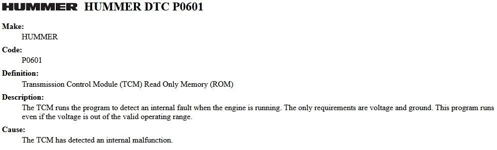

P0601 is a PCM issue with the read only memory circuit inside the pcm. a low battery can cause bad data in the rom.
as can noisy power that has spikes in the voltage from bad diode's in the alternator

When the fault first happened the battery voltage would have been low. After it happened the first time the mechanic swapped out the battery with a brand new, fully charged one. However it still happened another 3-4 times with the new battery and only on really hot days.

With that kind of idling and slow movement it leads me to think that the under hood temps are as you stated " something is expanding " The TCM could definitely have something to do with it.

I had a quick read on the TCM function. Would you expect that I would see fluctuations with RPM, or the car behaving weirdly before the error occured if the TCM was the issue? There is absolutely no warning before the car shuts down. Runs smooth and clean. It is quite simply as if the key is switched off and the car turns off. It's as if the car is in a protected mode until it cools down, as there is no response at all if I try to start the car immediately after while it's still hot.
