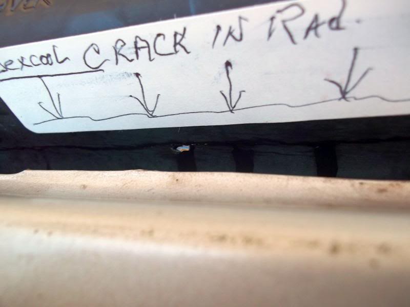

So many keep going on about the radiator leaking where it hits the frame. Well, that's not the only place it leaks due to GM fault.
On the right front of just about every Hummer radiator I have seen, about 1/2 way between the center and side has a "wrinkle" in the plastic top. This is where many also leak, including mine. I had insurance to cover it, and I told them the diagnostic fee didn't apply and to see the .jpg attached to the radiator.
http://i121.photobucket.com/albums/o...mmer_crack.jpg
Hope you can see the picture.
