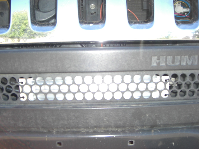

After replacing my radiator, I added an nice finned aluminum transmission cooler. It has dropped the coolant temp by about 10* and it dropped the trans temp too.
[/IMG]
Old Apr 18, 2013 | 11:33 AM
  #386
Gearhead Garage's Avatar
Joined: Jun 2012
Posts: 6
After replacing my radiator, I installed a finned aluminum tranny cooler, it has dropped the temp by 10*.

That tranny cooler looks great. It looks like the mounting holes line up pretty good with the holes in the grill, a couple of long bolts, large diameter washers and maybe some spacers between the grill and the cooler mounting tabs and you are good to go!

As I see it the thermostat has complete control over temp. it simply stays closed till the temp hits the setpoint. it can only get too hot if the radiator cannot get rid of the heat like in july,95.!
a tranny cooler cant drop the coolant temp since the tstat just stays closed till it get to the setpoint like in jan when its -15, still get nice heater heat!
