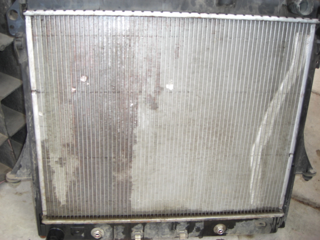

add me to the list.
Glad I caught it in time before it wasted my tranny.

Originally Posted by Gearhead Garage
add me to the list.
Seperate issue. The transmisson cooler is an internal problem that would not show up as an external leak.
