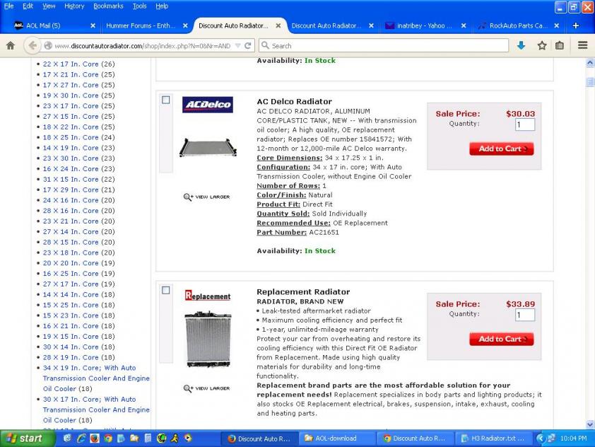

My '07 H3 has less than 40K miles on it. I've been smelling coolant for about 3 years and added less than a gallon over that period but could never find a puddle or leak.
Until this week when I finally noticed a small puddle and took a look. Didn't even know about this issue or this site until now.
Here's my question: What's up with the prices on this site? Could this even be remotekly possible? An aftermarket radiator for $15 bucks? An OEM GM rad for $30?
Anyone know what's up with this site?

Here's a screenshot:
Is this for real?
