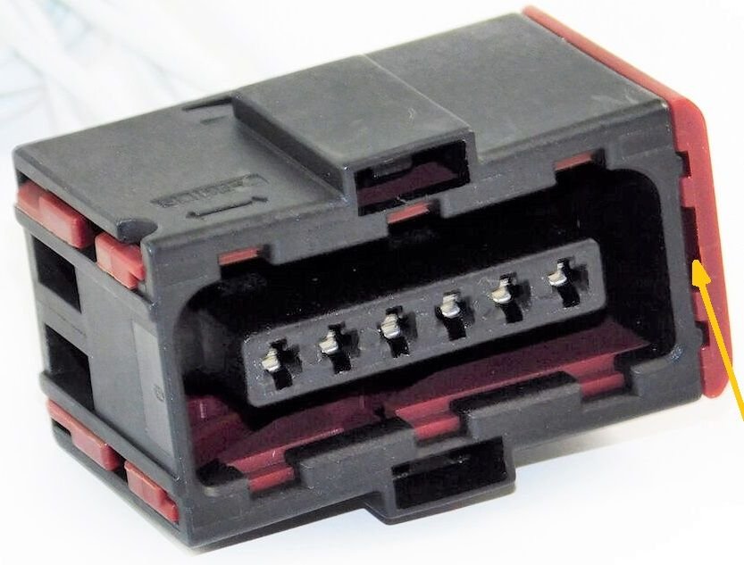

Sure, then get yourself a PT2631 and you will see how it locks.

I've looked at those. However there is a missing part on the picture. On mine there is a white piece on top that holds it on. If its not released, plug will not come off. There has to be a way to release it. I've messed around on this quite a while. Used a mirror to look, still can't figure what needs to be done.

I cleaned ( sprayed ) the plug and was putting the connecter on. The lock part sild down and I can't get the lock to slide up. So easy to take off. Secret to slide it back up? Will not lock in until I get the slide up. Hard to work upside down. When I get it back on, will see if limp mode goes away. Maybe buy a new pedal. Or not. May just tow it to the dealer.

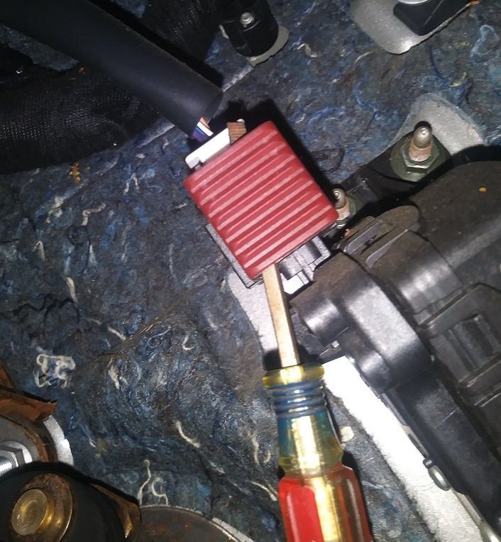

Yes, you can take it apart if the contact cleaning doesn't work? Did you clean the contacts on the APP sensor too? Make sure to insert your pocket screwdriver in the proper place:

Thanks, worked. I sprayed both the connector and pedal. Back together. Still in limp mode. Maybe buy a new pedal. I hate to keep throwing parts at the problem. And on I go.
