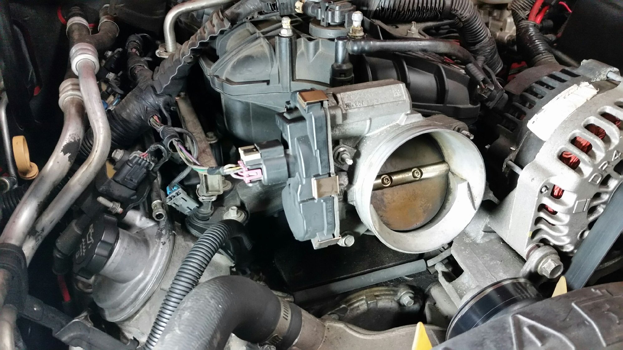

Remove the engine cover and take/post a picture of the wiring harness to the throttle body.

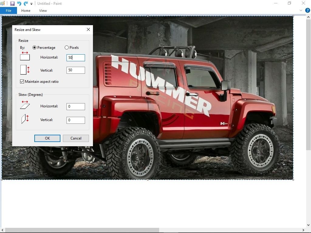

I took several pictures. I'll try and up load them, however I really don't know how to do that. Maybe my Granddaughter can help me when she comes over today.

Resize the pics with ms paint, then upload. There's a way to teach an old dog new tricks.

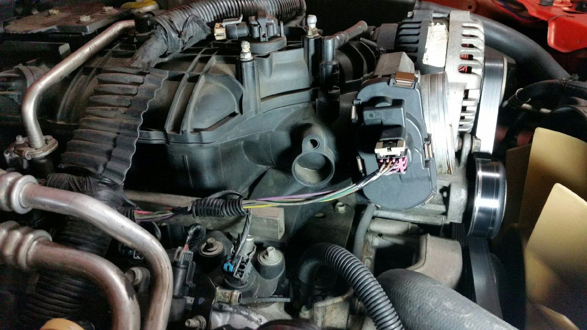

Green wire appears burnt. Take a close look/feel to make sure wire is still intact inside insulation.Wiggle to see if message disappears. Make sure to loom/protect the wires after repair. GL
Old Oct 3, 2021 | 04:05 PM
  #217
Posts: 9,018
Temperature range -30° to 200° Fahrenheit here>>>3/8 in. x 10 ft. Protective Wire Wrap
