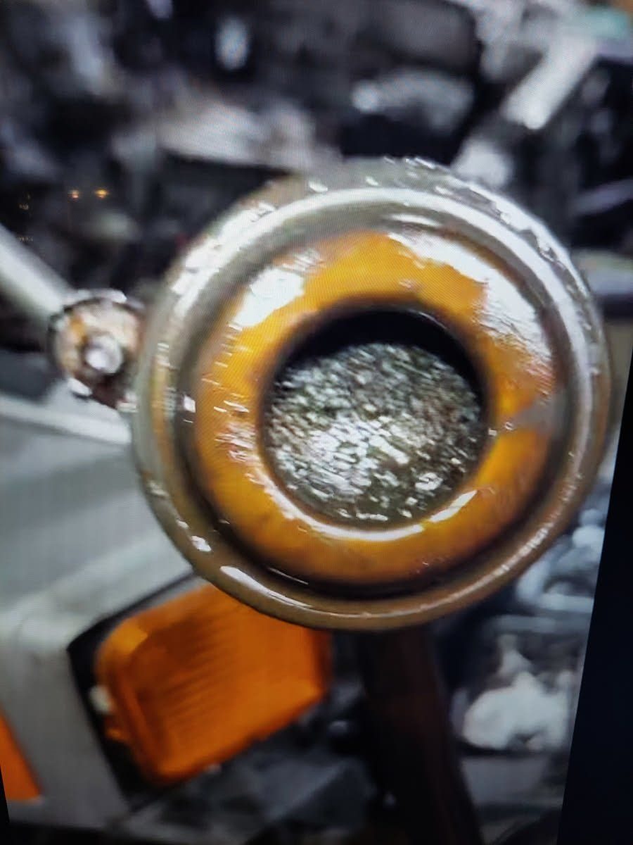

Oil light comes on when oil pressure reading to the OPS is below 5psi. Off idle the oil has the ability to increase pressure through the pickup screen above 5psi to prevent (((oil light warning))). Oil pressure test should be done immediately to prevent premature engine failure! Oil pump pickup screen:
do you have pull motor get to pick up ?

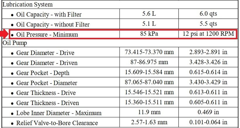

Update said in park at idle it’s 12 psi in gear it’s 8psi ? Said motor is gone

Startup idle is around 1200rpm's=12psi oil pressure. Oil light off @ startup idling in park?

so what’s your opinion I’ve read up on 10 psi per 100 rpm’s just reporting what shop said
At that rate, WOT=:
