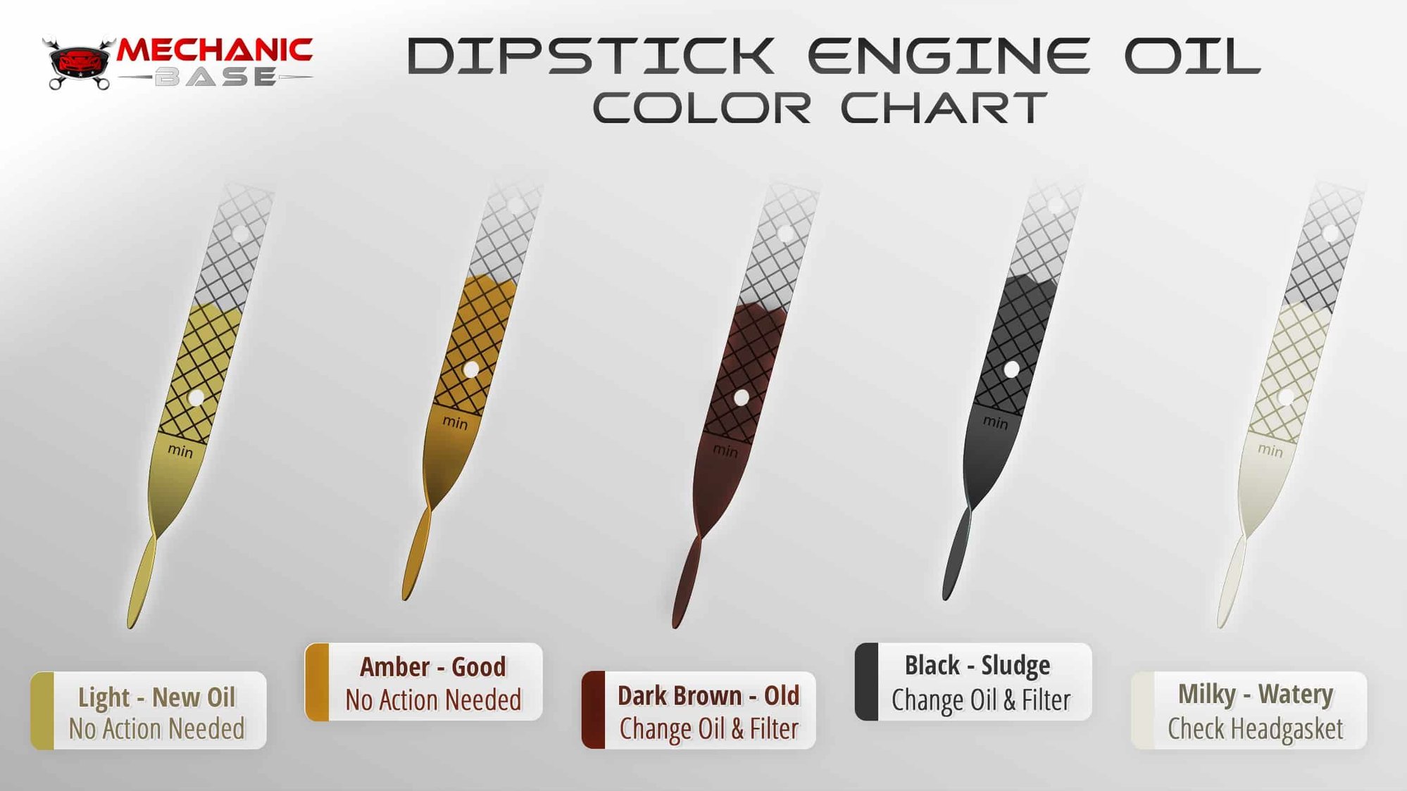

What oil did you use? Oil filter also replaced? What is the current color of the oil?(if black within 1000miles of oil change, flush the engine) Watch video below for more information:
