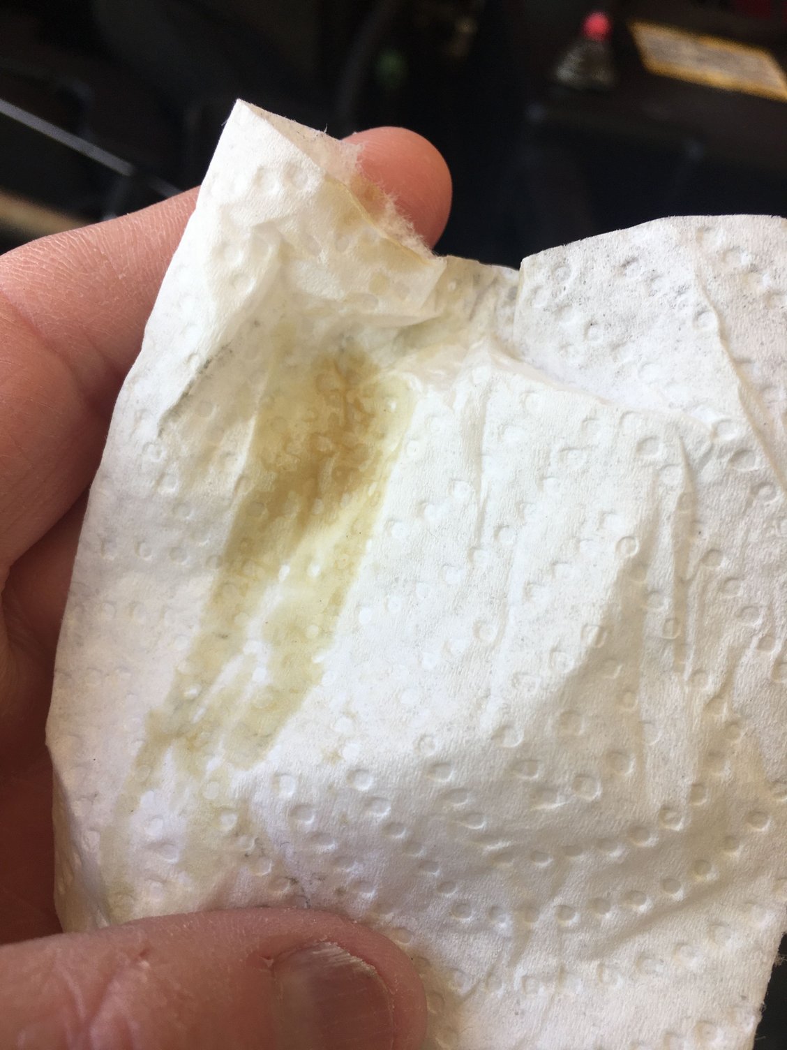

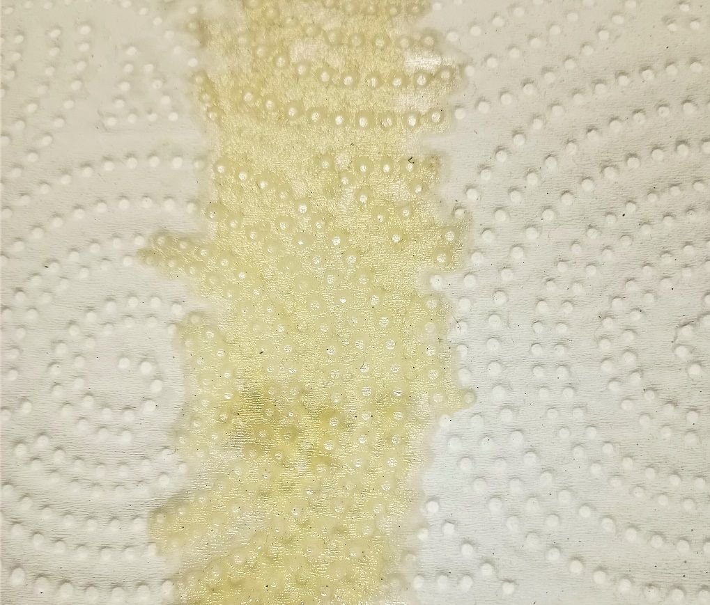

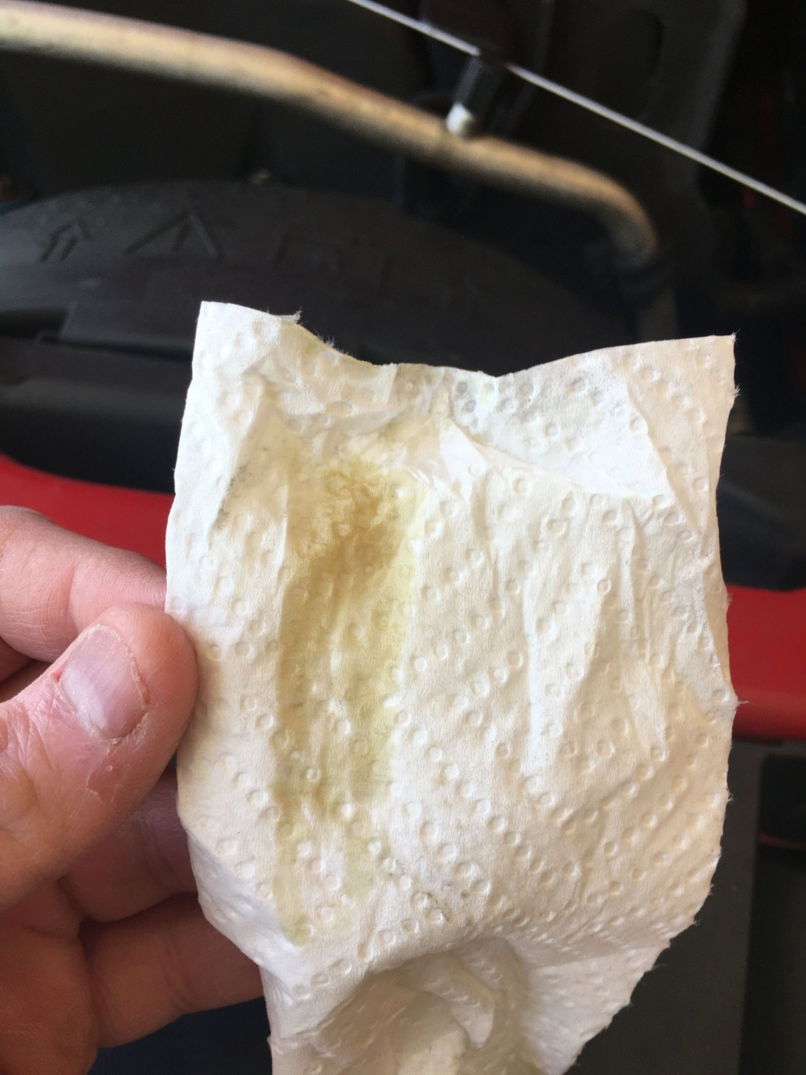

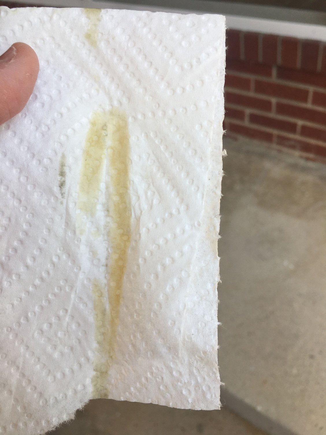

Originally Posted by Millertime045
bro I hope it’s nothing bad I love my hummer yea driving over 1000 rpm’s fine soon I stop ding ding it stays on steady I’ll keep this post updated in day or so
Manual oil pressure gauge test is the best thing to do at this point. What is the current color of the oil after flush & change? Wipe stick with a WHITE paper towel.
just hit 100 miles on new oil change
Old Apr 10, 2023 | 04:29 PM
  #57
Looks good to me. In the past I've seen oil turn dark after a couple minutes running fresh oil & check level on customer's oil changes. #SeaFoamWorks
