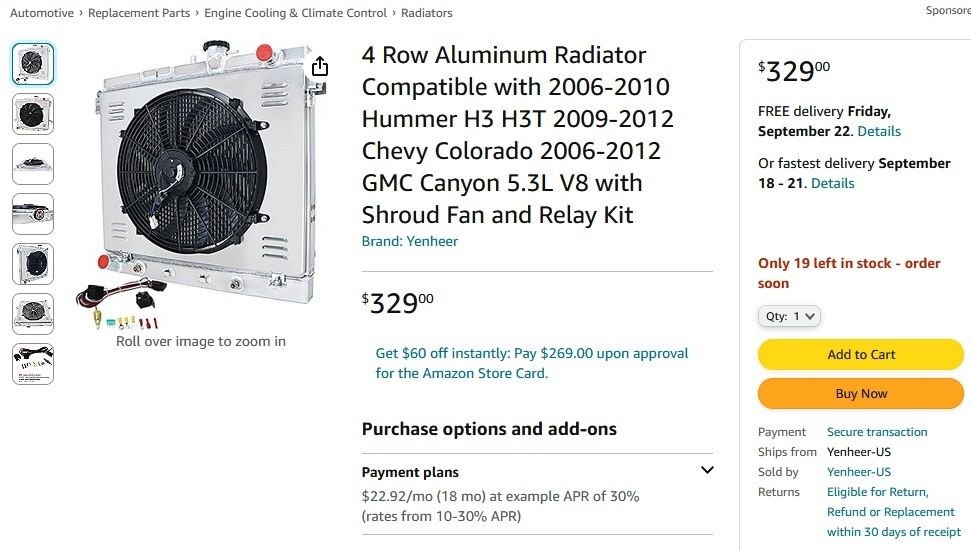

Originally Posted by NFS
4 Row Aluminum Radiator Compatible with 2006-2010 Hummer H3 H3T 2009-2012 Chevy Colorado 2006-2012 GMC Canyon 5.3L V8 with Shroud Fan and Relay Kit https://a.co/d/4Fu2Cy7
bought this big guy but I think the fan may be not strong enough to pull thro it like someone said here ? Cus it’s 4 row and it’s huge and even tho the Efan is 2250cfm still may not be enough for it and the condenser ? If rhat the case I’ll return it and back a 1 row

The link does not work for me either......... but either way, INHO you need more CFM from the fan. You might be able to salvage what you have with a higher output puller fan and be good. Lots of 16" pullers available at 3000 CFM that don't break the bank. Search "high output 16" electric puller fan" and see if it helps.
You could add flappers too it you want to do it up.
so here is the update I returned the aluminum radiator and put a brand new oem radiator I put a 2800cfm or whatever power fan . When the fan kick it I can put a paper or leaf infront of the grill it and it will suck it and stay sucked that shows how it sucking pretty good airflow . Still same ****inf heating issue, so so far I have new radiator , brand new coolant, water pump , thermostats and belt and belt tension and efan that pushes 3000 yet the hummer is at 3/4 mark ! Changed oil with mobile one and mobile one oil filter .Why just why!? It was 80 degrees this morning so it wasn’t that hot and it was at 3/4. Il burp the coolant system again this evening so o see if there is air still in there but for the love of god. The thermostat I put was motorad open at 187F I even drilled a tiny hole that some folks recommended to help getting rid of air bubbles and such
