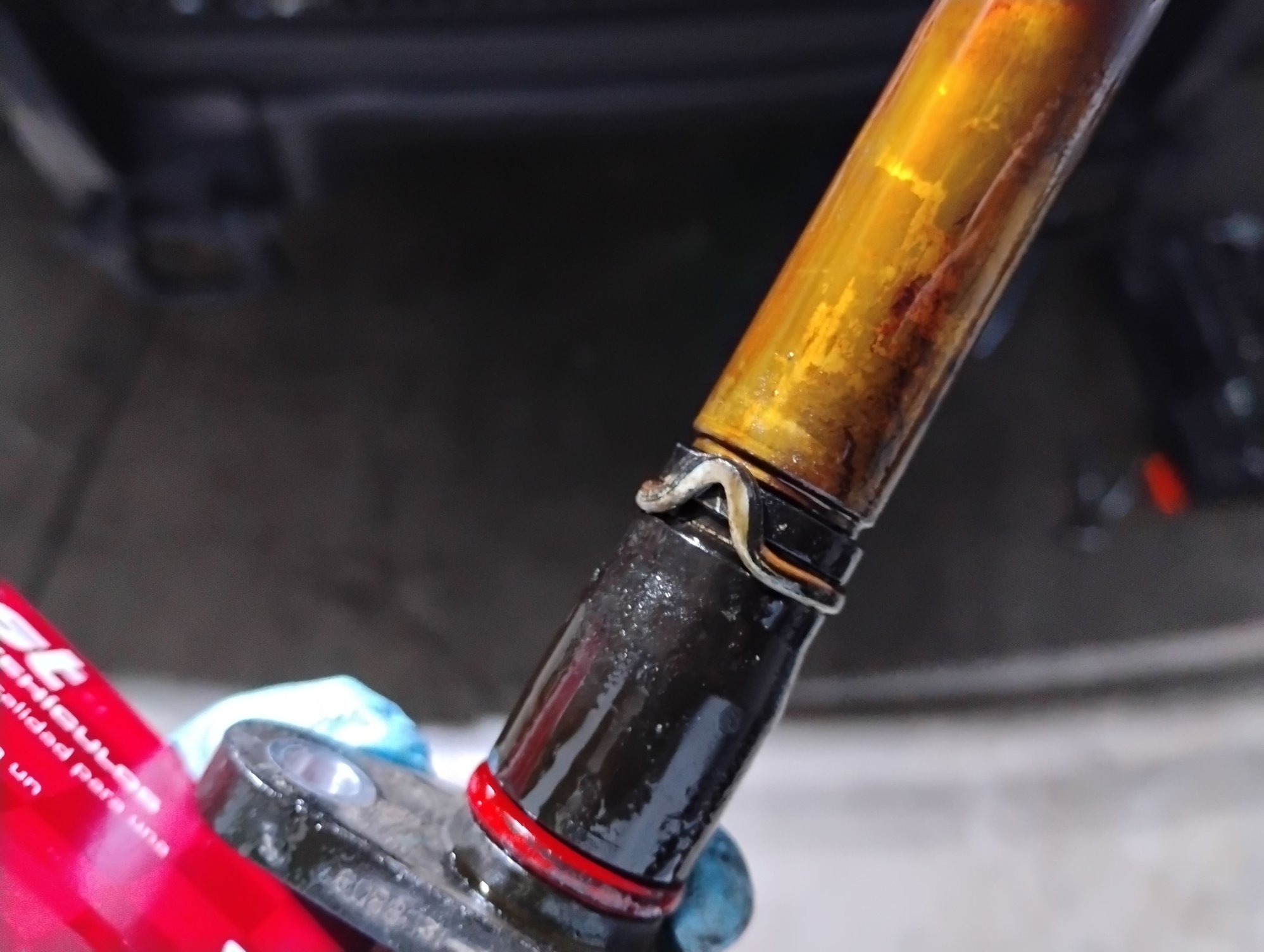

Looks like it was the crankshaft position sensor, replaced it and did the case relearn, no more crank no start - at least for now. If it happens again I'll clean the ignition switch next.
The crank sensor I pulled had one of the o-rings kinked and forced into the slot, it was pretty cooked on there. Not sure if that had anything to do with what I was experiencing.
