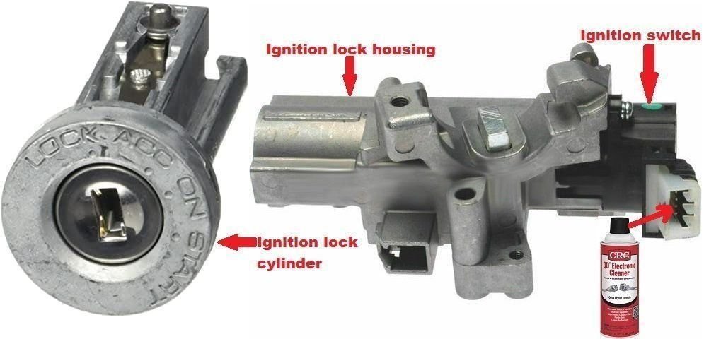

Old Nov 25, 2025 | 04:58 PM
MadDogBimmer89's Avatar
Joined: Jun 2023
Posts: 171
Originally Posted by Justinh
Yes this is what led me to replace my camshaft sensors. His problem was that his cam sensor was not properly seated. Not the same issue, but symptoms are similar.
I'm now thinking maybe my purge valve is stuck open allowing vapor into my intake manifold while the truck sits there after running. But I think I'd notice other symptoms if that was the case, fuel smell, negative trims, but I'm not seeing that. My other thought maybe it's the crankshaft sensor???
Old Nov 25, 2025 | 06:55 PM
Posts: 9,024
Old Nov 25, 2025 | 10:39 PM
Joined: Jun 2023
Posts: 171
I've found a lot of threads regarding the anti theft system, doesn't quite fit my symptoms. I don't see the locking light and it doesn't disable fuel for 10min - my symptoms only happen after the truck has fully warmed and if I let it sit for 10-20min. Also starts up on second try every time.
