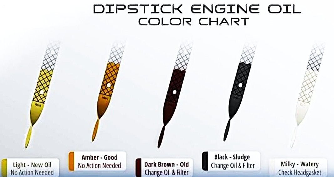

NOPE!
Piston rings fail due to a combination of excessive wear, poor lubrication, overheating, and contamination. Chronic issues like not changing the oil or filter, engine overheating from a failing cooling system, or damage from dirt and debris lead to increased friction and premature wear. Ultimately, this causes the rings to lose their seal, leading to decreased compression and performance.
Monitor engine oil level & color:
This is basic stuff isn't it?
