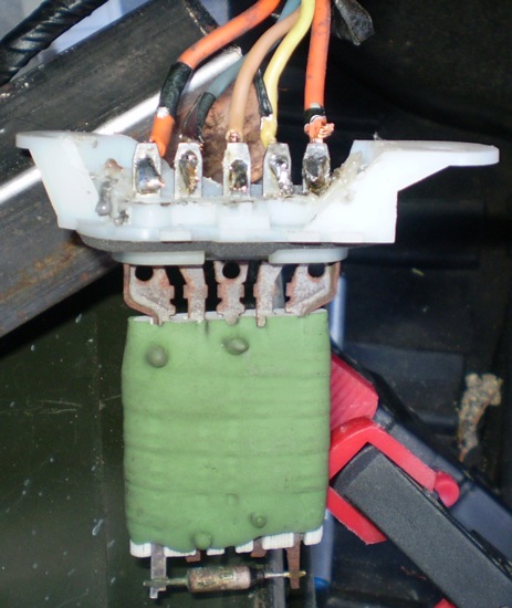

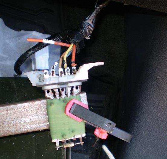

Default Fix worked perfectly- took a bit longer...
I too, thank you for posting this fix.
I took a slightly different approach- First, I couldn't get the pigtail harness completely off my H3. There were two wires that routed into the side panel of the dash and I didn't want to take any more of the dash apart. I only dropped the glove box.
So, I decided to do the repair with the harness still attached and do the soldering inside the truck, below the dash.
I needed vise grips to remove the connectors, because they were melted together on one side. It was stuck together far worse than I expected. I removed the resistor. I then drilled holes in the finger tabs that plug into the socket.
My goal was to feed the wires thru the back side drilled holes in the finger tabs, which would hold the wire in place as I soldered the connection. This worked for me (see photos). It takes a lot of heat to get the parts hot enough for the solder to flow- so expect to hold your soldering iron in place for 30sec-1min before trying to flow the solder, with a cheap soldering iron. I was able to complete the job in 2 hours, and it has worked flawlessly for a week now.
I liked the idea that someone else had about drilling out the melted connection, and only soldering one wire thru the hole. While this is a good idea, there is a chance it could melt the connector again. I'm not sure if this was talked about, I didn't read all the pages- but root cause of why the connector melted, was due to the high current flow in that one wire resulting in excessive heat. If this connection was designed correctly, it would have heat dissipating properties- the connection should be ceramic or some other substance that could dissipate the high heat from the current flow in this line. The plastic connector could not dissipate the heat, resulting in melting. This is why simply replacing it will not only be costly, it will definitely fail again. I saw a brand new resistor in my auto parts store, and it has the SAME exact plastic connector - it was not redesigned at all.
So, while drilling out the connector and soldering this one line will work, however, the wire still being inside the connector may result in not have enough airflow around this connection to dissipate the heat, resulting in the connector melting. This fixes the symptom (the connection failure) but not the root cause (the lack of heat dissipation). If the connector melts again from the high heat, it won't ruin this connection again, since the line is now soldered, but it could ruin the next connection over that is still in the original connector. Keep your sense of smell aware for any burning plastic smell with this fix. I'm not saying it this melting will happen, but there is definitely a chance. I've worked in electronics repair most of my life..this is only my .02
So, this is why I went with the fix to solder all the wires. Completely getting rid of the orange connector, and cutting away part of the white resistor connector *may* give this connection enough air flow to dissipate the excessive heat. The jury is still out- I'll wait a bit longer before I am sure. My photos are attached..

Here are my photos
