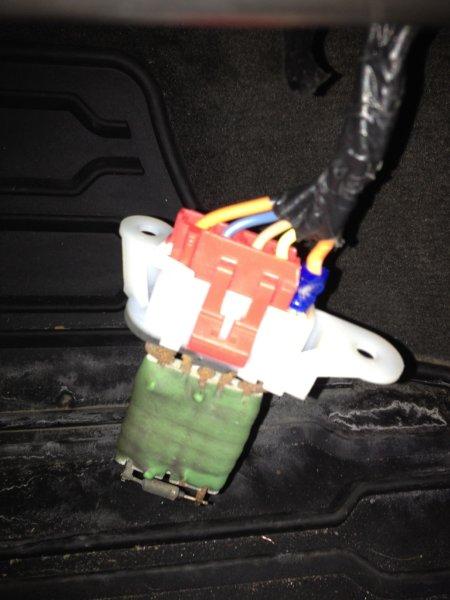

Just got this same issue at about 177K on my 06 H3, really glad I found this post.
Thank You all for the input and the pictures got my heat back when I really need it. Winter and no heat is not a fun drive to work.
I decided to keep the clip with the 4 lines that where good and just remove the 5th wire where it melted and cleaned the clip, cleanned the 5the line and connected that to the pin by its self.
Attached is a picture of what I did.
