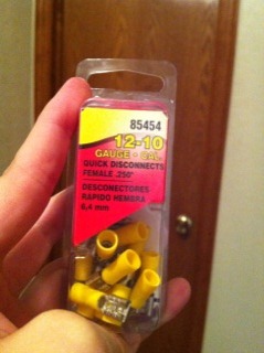

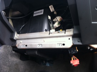

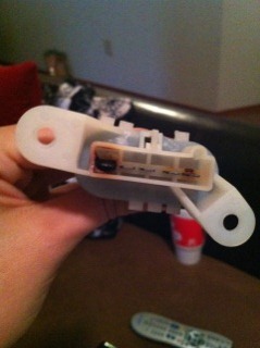

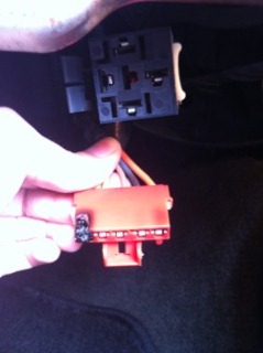

This is what my resistor and connector looked like after it melted. I cut the original female connectors off and replaced them with new connectors, completely by-passing the red plastic harness. I first removed the plastic from the new connectors (so nothing else could melt) and manually opened them and secured them to the wires. It was super easy and my AC is working great.
