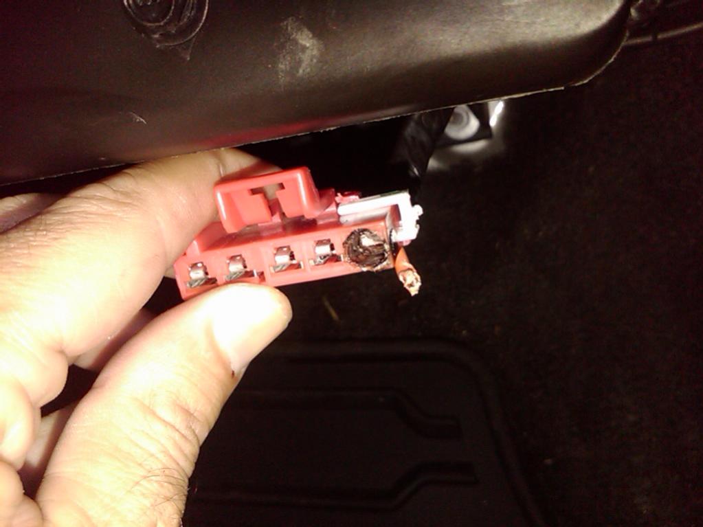

I cant seem to get the connectors apart. I pulled the white tab out. Is there any special trick?
Old Aug 12, 2010 | 06:22 PM
Autopilot's Avatar
Joined: May 2010
Posts: 35
Nevermind....I got it. It was totally melted together. Surprised my truck didnt catch on fire. Here are a few crappy cellphone pics...

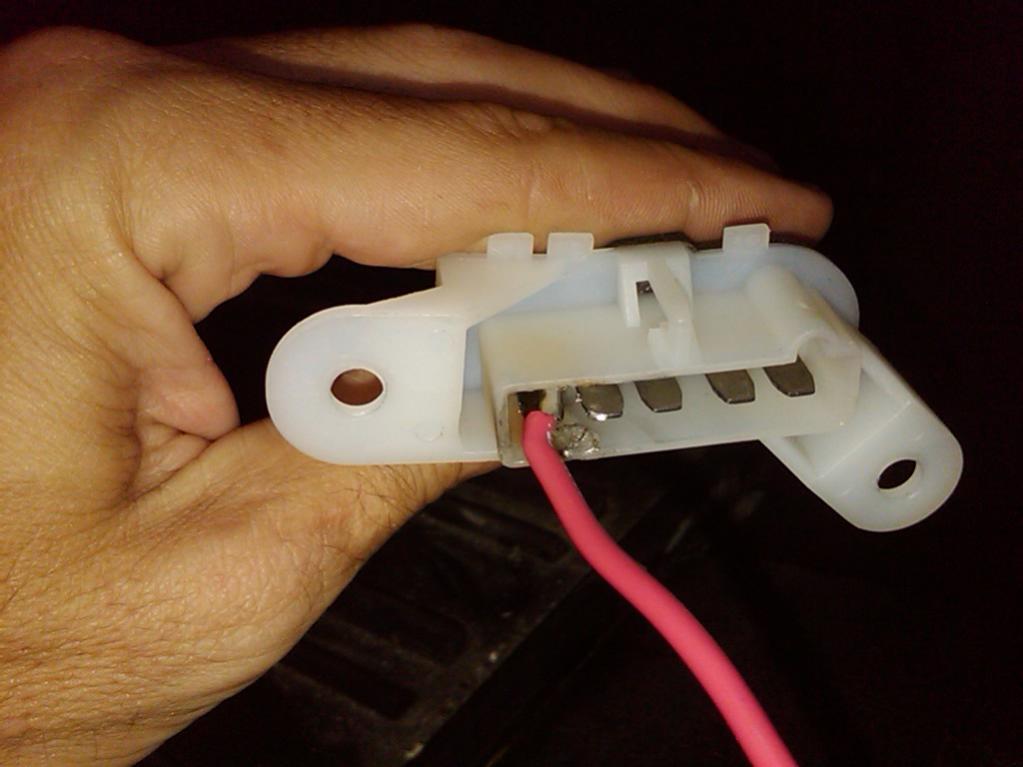

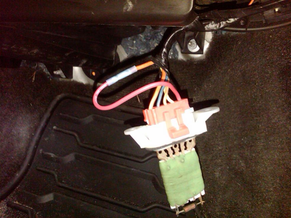

Great info...I took a little different approach. I cleaned the contact. I soldered a wire onto the one terminal only. I drilled out the melted plastic male connector and removed the wire. Then I plugged it back together with the wire running through the enlarged whole and connected it to the source wire.
Attached Thumbnails AC Blower fix-img00407-20100916-1648.jpg   AC Blower fix-img00408-20100916-1714.jpg   AC Blower fix-img00409-20100916-1715.jpg   AC Blower fix-img00411-20100916-1719.jpg
