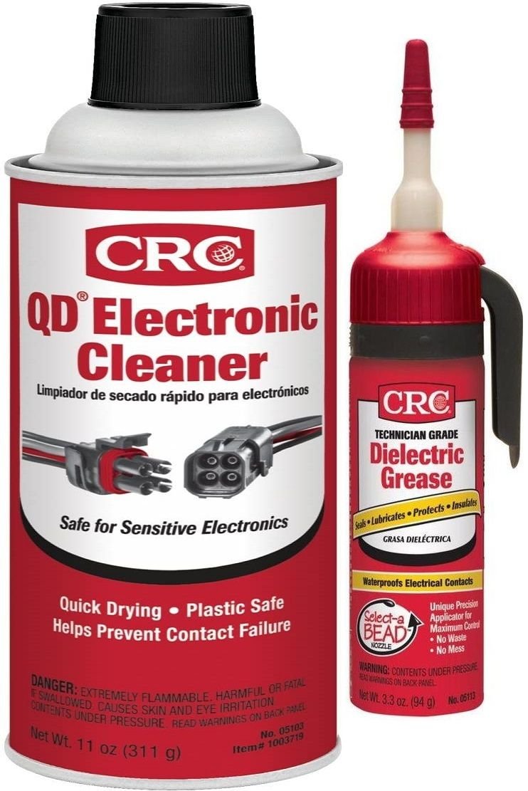

Clean/seal the connector/contacts left rear wheel speed sensor. C0276 info below.

I would get that special sauce I posted above and clean/lube connector/contacts to the encoder motor. Then cycle the switches again.

i have that sauce lol. So spray it on the sensor connector on the back and clean the plugs that goes into the encoder motor that on the passenger side that have the plugs connected to? The TCCM?

Start with the ENCODER MOTOR connector. You have that special sauce yet don't know how to use it? Spray it into the connector, and contacts connected to, spray away.... Let it dry, connect / disconnect a couple times, then seal with dielectric grease.
Yes, check/clean connector to TCCM if that doesn't correct.
