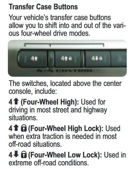

Default Update
UPDATE
got the new encoder and installed it and it fixed the problem ! Now the 4 wheel high light is on and it switching between all of them with no problem!
I have a stupid question. When to use 4 wheel high lock? And 4 wheel low lock? And what the speed that you shouldn’t go pass on those setups? I was missing around the buttons and I put it on 4 wheel low lock and put it on drive but the car is like very very sluggish and barely want to move . Is that normal?
thanks alot guys
thanks alot guys
I still have never needed to change from 4H?Getting to Know Your H3

Okay but does the 4wheel low lock usually sluggish and car barely move? Maybe cus it’s not meant to be activated on dry surface?
