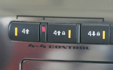

and yes I swapped them and checked the fuses still won’t let me go any wheel drive and still have the same code

yes! It’s not ac Delco but ac delco want 280 for their damn motor that shifts so I ordered thag one off eBay. It should do the same thing .
you don’t think it’s my shift fork?
the car still drives even with none of the 4 wheel drive button lights are on

The selector switch power comes from fuse 58, go back to switch and check for power.
idid and the fuse is functional when I press on any of them it will blink for few seconds and the. Goes away and the light won’t stay on. And I would that that and code all the time now
