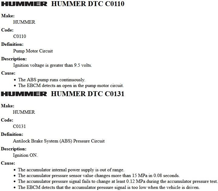

Originally Posted by sfradkin1
C0110
C0131
Thanks!
Clean connector/contacts.
Old Jul 26, 2023 | 04:59 PM
Posts: 3,217
if the pump is not running then there is no pressure.
that then sets the second p0131 code

Thx - pump IS dead. Original diagnosis confirmed, as expected. Now what? As per original note, this part is not available anymore. Suggestions? I did speak to someone about used parts, but these seem to come untested from salvage yards and this person has had to try multiple parts on various occasions.

Who diagnosed? Did they inspect connector contacts & check continuity? Btw, many sites show 15240729 pump available.
