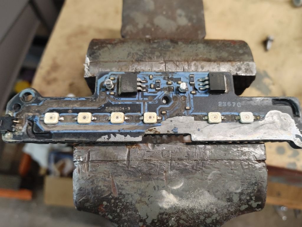

My CHMSL was in really bad shape. There was one LED, a capacitor, and some broken plastic loose in the trim panel when I removed the CHMSL. The part of the circuit that remained (a printed circuit built directly on the heat sink, no PC board) was badly corroded. I couldn't even save the connector.
If GM wants to build the circuit this way, they really need to conformal coat it at the very minimum.

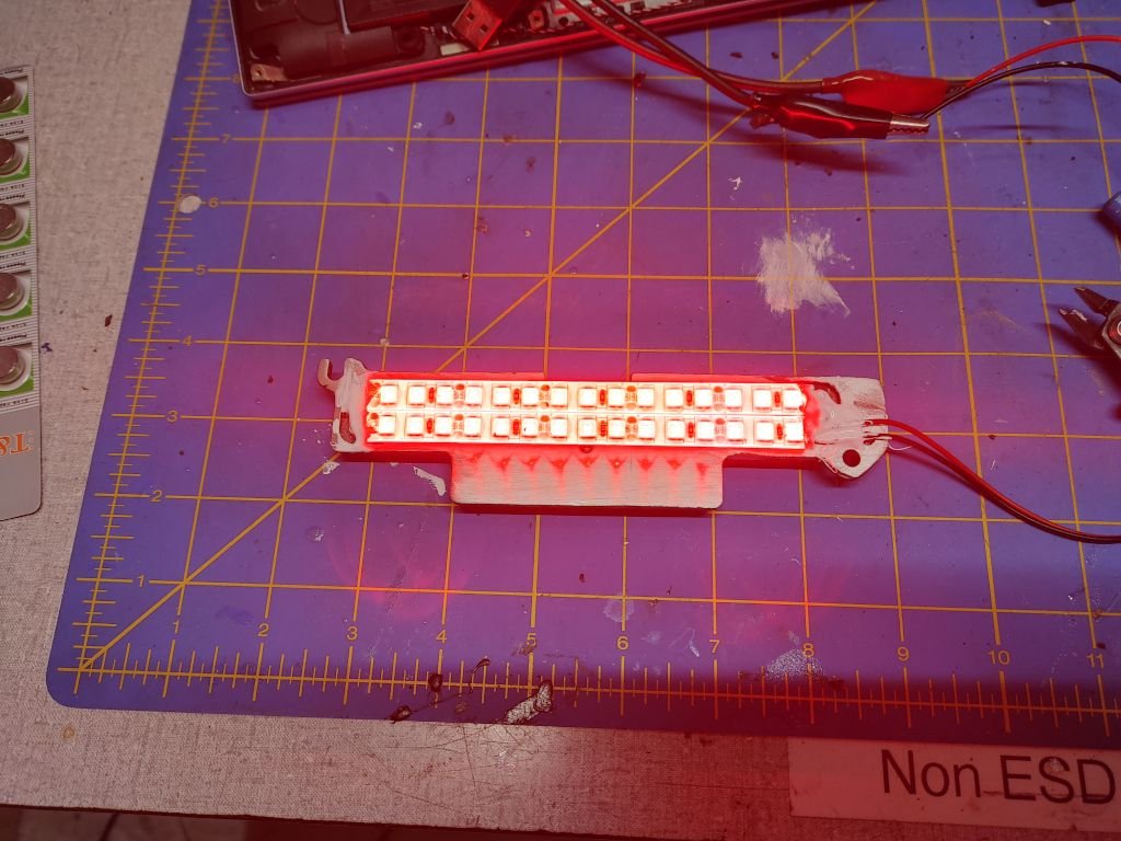

Here's a bench test:
Total draw in this configuration was 0.43 Amps, according to my bench power supply.

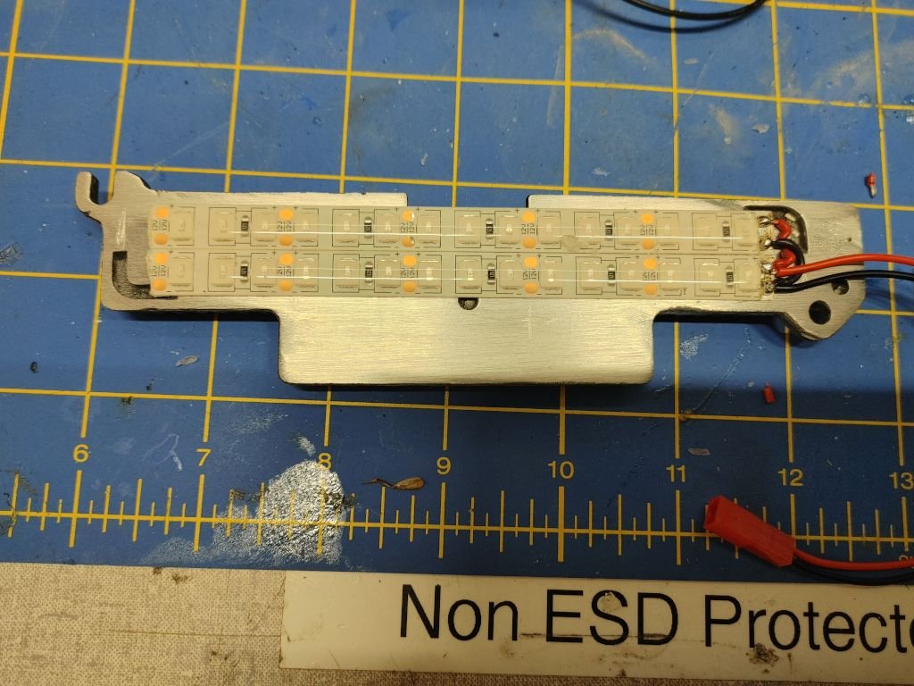

Note that I have applied marine sealant (3M 5200) to the ends. These LED strips are IP rated, but we need to seal the ends and the solder connections. The way I did this, it should not just be moisture resistant, but fully submersible.
I also had to build up the plastic where the heat sink is attached to the CHMSL housing. The screw holes were brittle and broken.
Here's a bench test after re-assembly. Note that the inner focusing lens is removed. I think it has a good pattern. Note that I had to use a JST connector since the original connector was corroded.

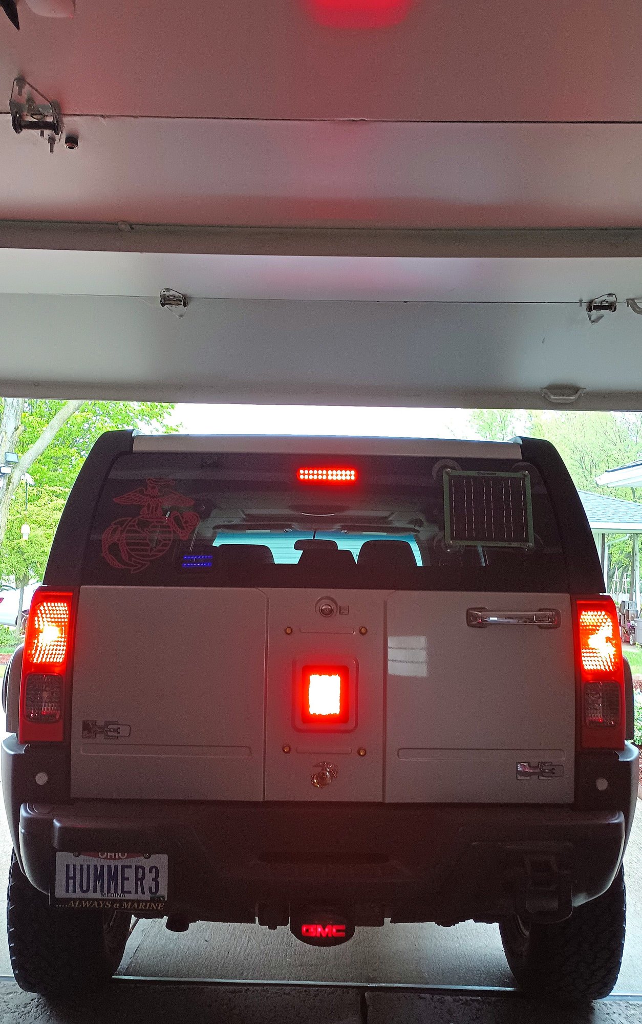

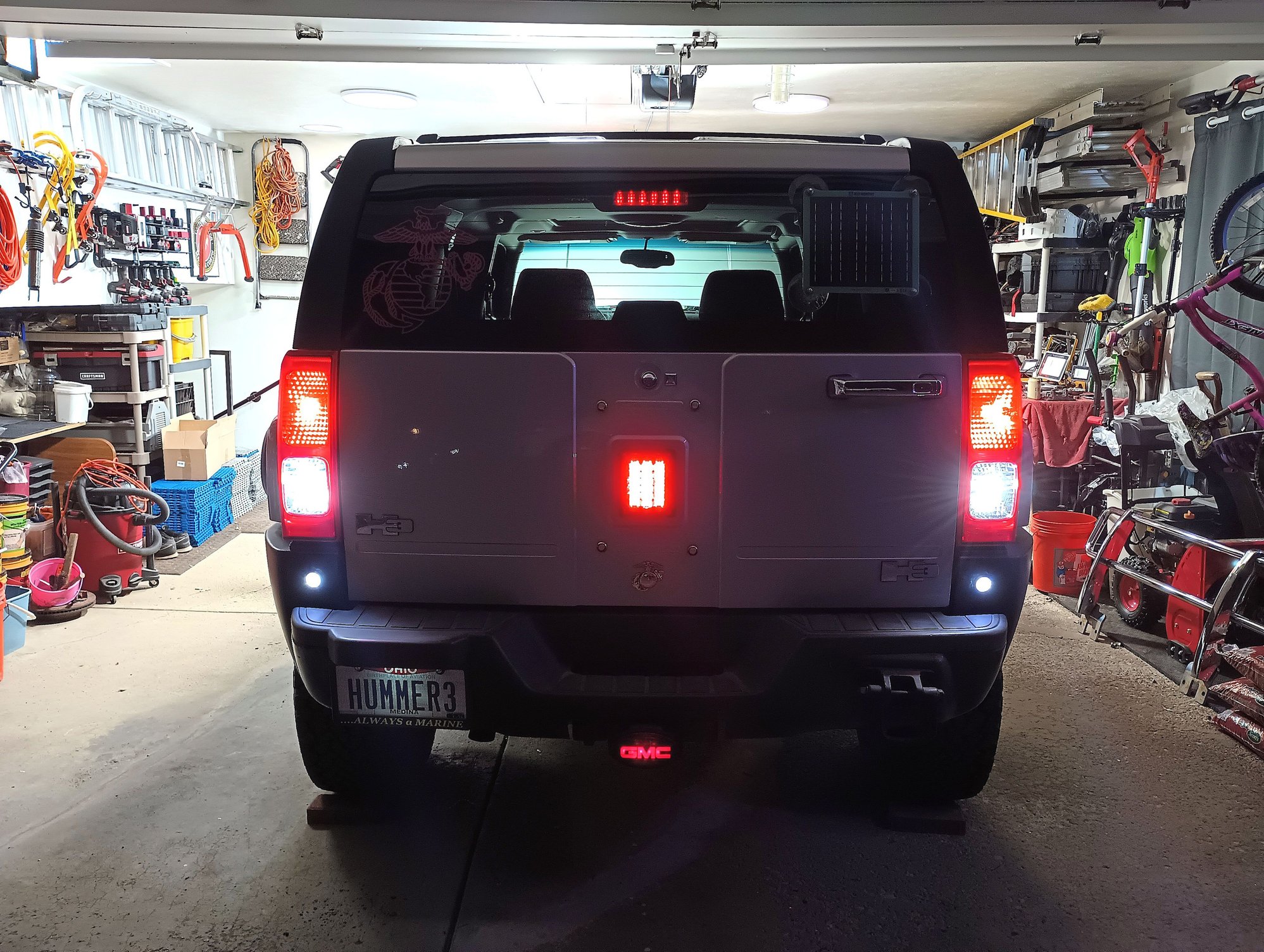

Here's a picture of the final result:
Less than an hour's work (not counting an extended break while the marine caulk set up), and no new expenditure, as I had a full roll of the LED's, and the JST connectors on hand. I actually wasted a few inches of the LED roll, as I cut one strip in the wrong place.

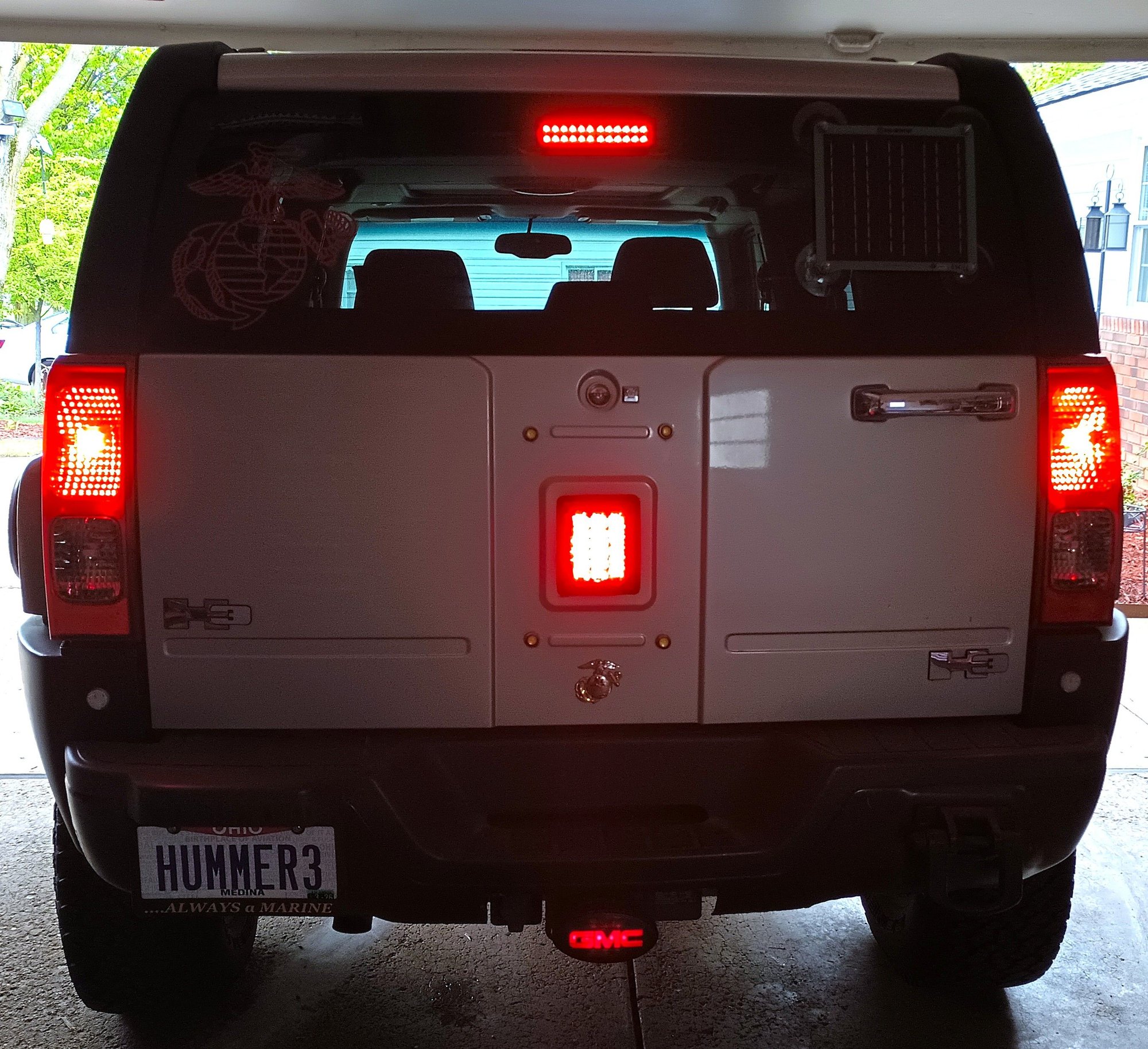

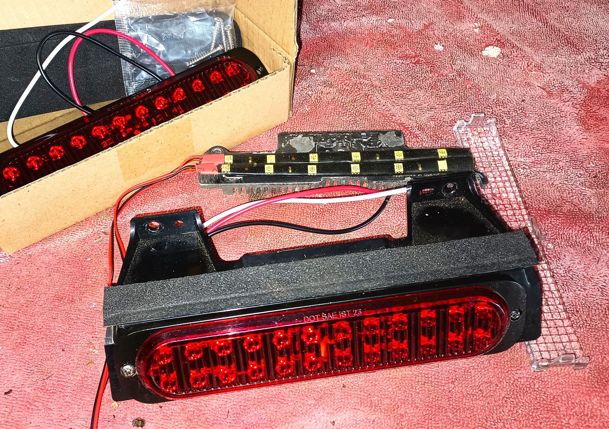

Vine sent me 7.5 inch Aluminum Housing Red Stop Brake Turn Signal LED Trailer Lights 24LEDs
Years back I installed 2 led strips into the high mount brake light, however not bright compared to my other brake lights.
I gutted the housing front & rear then installed this light on the front with 2 screws after drilling pilot holes then remounted on the upper door panel.
These lights have 3 wires White=Ground- / Black= +low light / Red = +high bright light. I only connected to the high mount original wiring blue to red & black to white.
Huge difference in light output viewing in person compare the before>>>> after:
