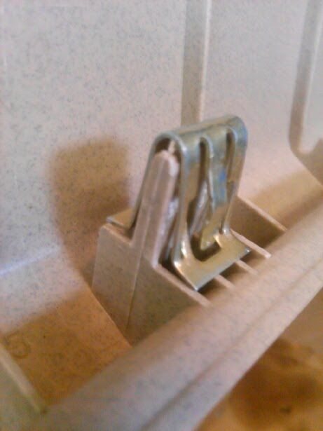

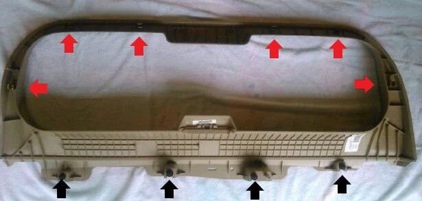

This old thread was helpful when I just replaced my '07 H3 third brake light (CHMSL) with the aforementioned instructions/red LED strips. However, I mounted my LEDs inside the housing.
I noticed in some other threads that some people had a hard time removing upper trim the rear/hatch door without breaking it and had to spend $200 bucks to buy a new one. I couldn't find a pic to show the clip locations, so I thought I'd supply one to give a reference for others that will be doing this job in the future. A trim tool pry set is useful (and cheap). Mine came off fairly easily but I moved slowly, was very deliberate and was very careful.
RED arrows show the locations of the metal clips that are the problem -- black arrow shows the plastic (plunger type) clips that are much easier.
And this is what the metal clip looks like close-up:
