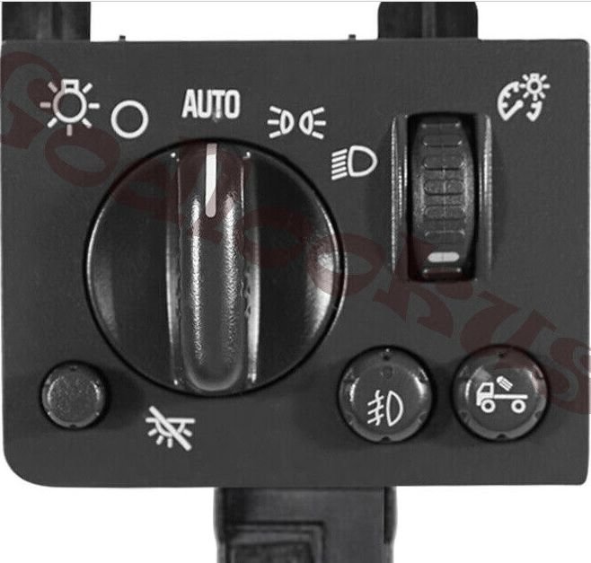

the bottom button on that switch all the way to the right that has no markings on it what is that for? my factory switch on that button has markings on it indicating "on star" ?
The buttons are removable, swap them.

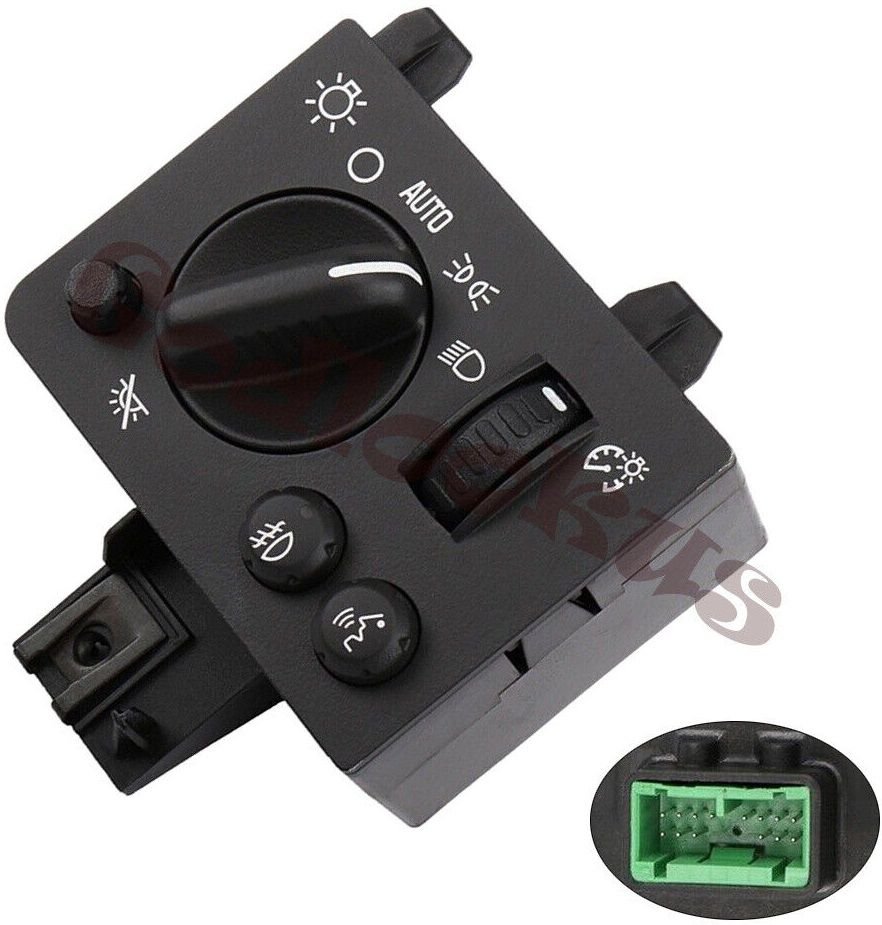

so are you saying the un marked button were talking about is wired for the "on star" and this switch is plug and play?
Old May 10, 2023 | 07:10 AM
Posts: 9,018
The coly used that switch for bed light or on star(pics below). Yes plug and play same 14pin connector.
