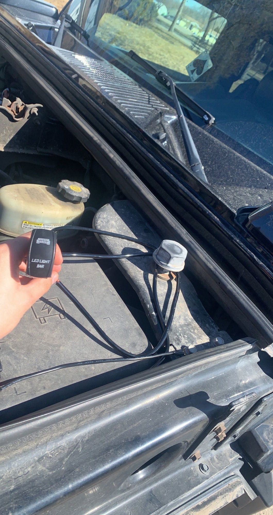

Connected some aftermarket fog lights and they look good just don’t know how to get this switch in the inside of the hummer? Help plz

here is an option for where the On star is,
Old Apr 4, 2022 | 08:23 AM
In this thread I detailed how to wire in a factory fog light button from a Tahoe/Yukon/Escalade. https://www.hummerforums.com/forum/h...-lights-39090/
The rear wiper/fog light buttons are cheap on eBay but it does take some work to do it this way. You need the button with a cut pigtail, plus a latching relay module from Amazon (since the factory button is momentary). Gives the cleanest and nicest appearance.
Next best option is to get a smaller switch instead of that larger Carling clone switch, drill/cut a hole for it and put it in the same place a factory switch goes in the blank area below the rear wiper switch. That type switch you have is too large to fit well in the spot where a factory button would be.
