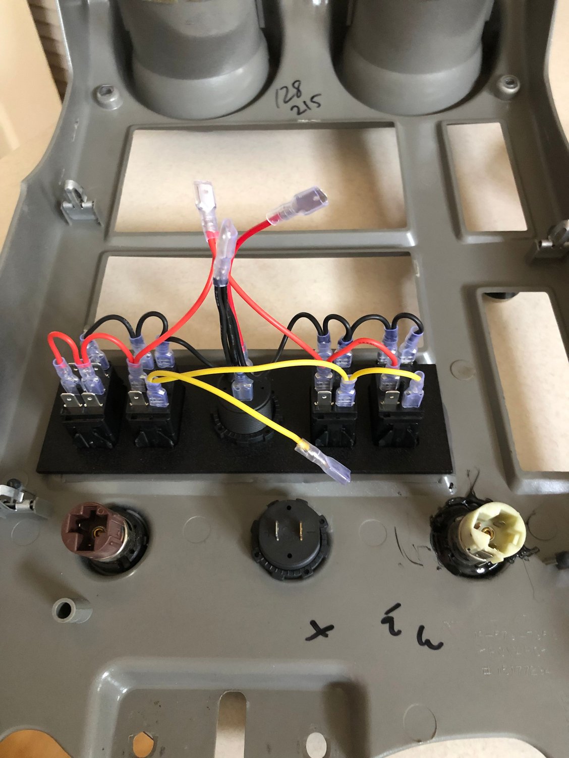

Hey all, so I just completed a little project to fill the ugly hole left by removing the OnStar. I reached out to Full Spectrum Plasma through Facebook, and had him mock up and cut out a plate 7-7/8” X 2-1/2”, with four rocker switch gangs and a 1.18” hole in the center. He painted the plate black and it matched the rest of the dash almost perfectly.
I filled the switch holes with some MICTUNING laser engraved rocker switches that have a blue light. I put in a voltmeter in the center and they all fit perfectly.
When I got the plate I considered gluing the plate to the back of the face plate, but didn’t want to ruin it for the future, so I decided on double sides 3M trim tape around the back side, and mounted the plate to it. It holds really well and can be removed later if need be.
The wiring took a bit of time, but works out really well. All of the lights on the bottom illuminate when the headlights are turned on, and the top lights turn on when the switches are turned on. When the headlights are off the bottom lights are off.
Let me know what you guys think and if you have any questions. Thanks for looking.

Thanks all. Yeah it came out really well. The guy who was making the 3D printed pocket stopped making them and won’t make any more. I contacted him about it and he said he isn’t doing them anymore. I like the carpet idea that people have used before, but for me the switch plate made more sense.
Putting a kit together like this would be hard at all, I think for all it was about $70 total, with the custom cut plate. And depending on the switches chosen you could see a little difference in price.
I wired them all up in a nice clean manner as well.
