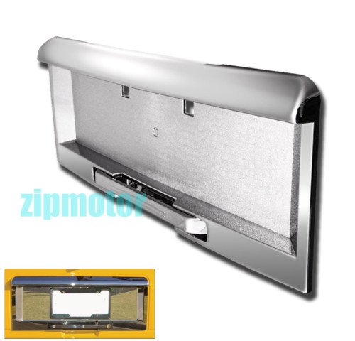

I found this licence plate pocket,all crome for 03-05 H2 Hummer.Here is the item ad..
03 04 05 HUMMER H2 SUV REAR LICENSE PLATE FRAME CHROME Item condition:New.84.00 US.The ad says they have 10 in stock.
Made From Automotive Grade ABS Chrome
Enhances The Look Of Mirrors For A True Custom Look
Perfectly Matches OEM Chrome
Uses Pre-Applied Red 3M Tape For Easy Installation, No Drilling or Cutting Required
Only thing it does not mention if it has a licence plate light.I sent the seller a email to let me know if it does.There outfit is called ZIPMOTOR.

Where did you get those first two pictures? The ones that aren't completely chrome? I'd confirm with the seller that you actually get the entire replacement pocket. I'm usually suspicious of chrome accents for sale as being just pieces that you stick on top of your existing pieces using 3M tape.

mrvictory1999's Avatar
Joined: Mar 2011
Posts: 77
I've heard the same thing about the chrome stickers being more durable. But he is looking for a license plate pocket that has holes for the lights. If the item for sale is just a few plastic chrome stickers, it won't help him accomplish his goal.
Has anyone here drilled holes in an 06+ H2 license plate pocket to add lights and relocate the license plate to the center of the hatchback?
