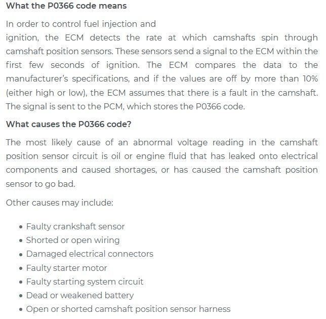

after taking the 09 exhaust camshaft position sensor out of the 07 rebuild, I put the 07 exhaust camshaft position sensor in the 07 rebuild, the starter would keep cranking the engine after letting go of the key. Key switch, or starter?? I found a gm tech 2 scanner on Amazon for under $500., wonder lf it would work for me. First gm tech 2 scanner I looked at was $2500. to &3000.

Great, back to the LLR, same displacement, yet some mods were added to the '09.
