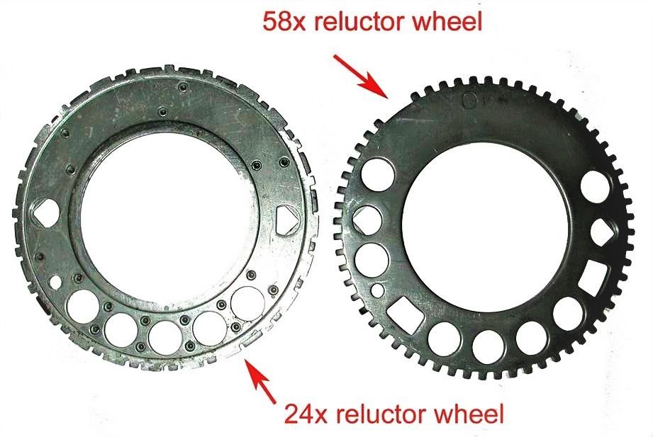

Isnt the 2007 engine a 24x and the 2009 58x? I cant believe it is even running at all!

"2007 engine a 24x and the 2009 58x" What does that even mean?

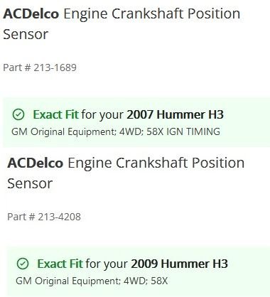

The '07 uses a different CKP vs the '09, yet both are 58x.
Old Oct 9, 2021 | 04:14 PM
Posts: 9,015
