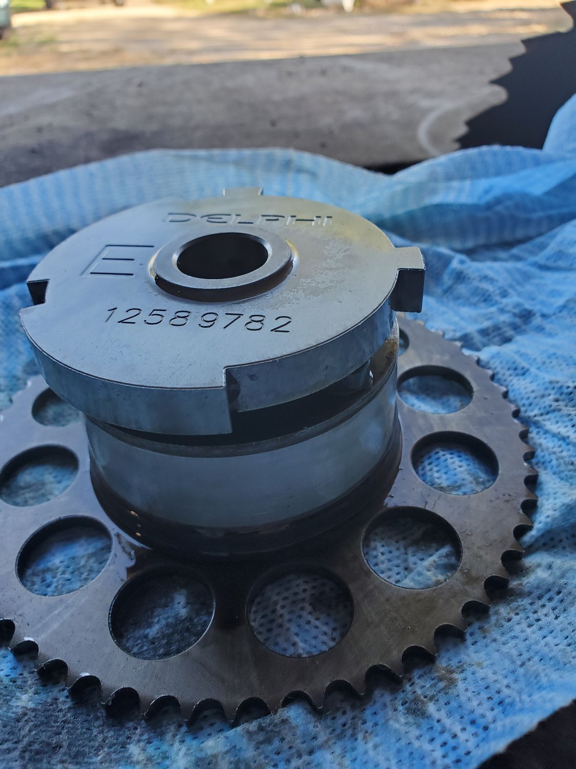

What "actuator" are you referring to?
I called it the acuator, it's the exhaust acuator that the reluctor wheel is attached to. But the reluctor wheel is the problem! I was going buy the acuator new, with the reluctor wheel on it already..
Old Oct 20, 2021 | 08:43 PM
  #22

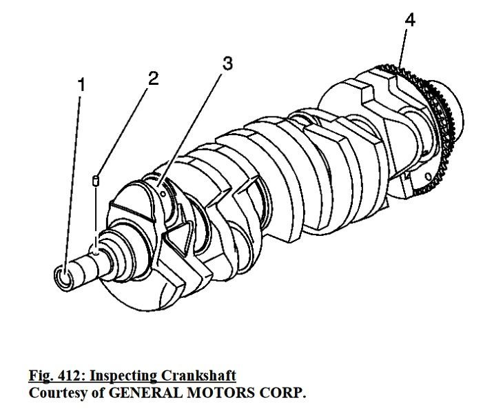

Wtf is that gibberish?
Btw, the reluctor is the same on all LLR's--> 12691185 (2007-2012 58x)found here(#4):
This is what I'm talking DA. read what I wrote before u run your mouth. I said exhaust cam not crank. What a dumb A..
That's not a RELUCTOR! It's a SPROCKET.
to begin with, I was saying the acuator is different on 07engine, than the 09engine. Someone put pictures of reluctor wheels on here, so I assume the sprockets on the acuator were called reluctor wheel. I would have called the reluctor wheel a sprockets. both of us was reading on different pages, you thinking crankshaft, and I was talking camshaft. The bottom line is, you can't put a 07 camshaft actuator in a 09 engine, and get the 09 to run right. But the camshaft are same in both engines, so if I put 09 camshaft acuator in the 07 engine, I can get my 09 hummer running right. Or get my 09 tuned. I hope I explained myself right this time. I'm not a expert on these engines, that's why I'm on here asking for help. And I apologize to everyone for my rudeness.
The actuator solenoid (VVT)is the same on all LLR's. The difference from '07 & '09 is the CMP & CKP.
if the acuators are all the same,, how come 06 has different part # than 07, 07 has different parts # than 08, but 08 thro 10 have the same part #. If all acuator where the same,, I wouldn't be have the problems I having now..
You need to ask yourself those questions? I gave you the link to adapt the '07 LLR in the '09. Live and Learn!
Thank you, the gm tech 2 is to much money for me, and all the shops I called, that does the tuning on pcm's, acts like hummer something they don't want to deal with.
definitely a Democrat
I will try to ignore your political view. An elephant, being conservative, would swap the sensors from the original engine to the donor.
