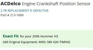

The '07 uses a different CKP vs the '09, yet both are 58x.
The 2007 is definitely a 24x I have a 2006 3.5L 24x in our 2007 that blew the 3.7L 24x. plug and play no issues.
Old Oct 11, 2021 | 10:55 AM
The '06 uses the same CKP as '07.
