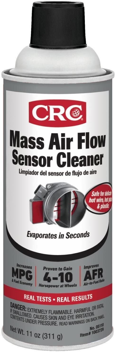

Clean the MAF+Check/Replace air filter.
just finished doing that and it idled for 30 minutes. The throttle body looked pretty clean though
Old Aug 5, 2021 | 04:47 PM
The MAF is responsible for calculating the total amount of air entering the engine. A contaminated or failed mass air flow sensor cannot measure the amount of air flow correctly. This causes the engine computer to miscalculate the amount of injected fuel, There are 3 key signs that may indicate it’s time to examine your MAF sensor:
Stalling, jerking, or hesitation during acceleration
