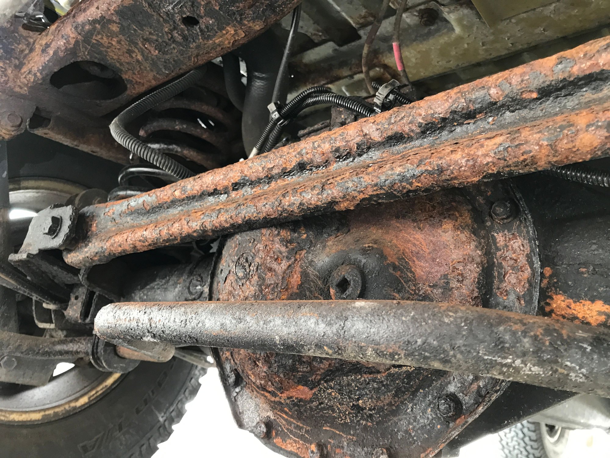

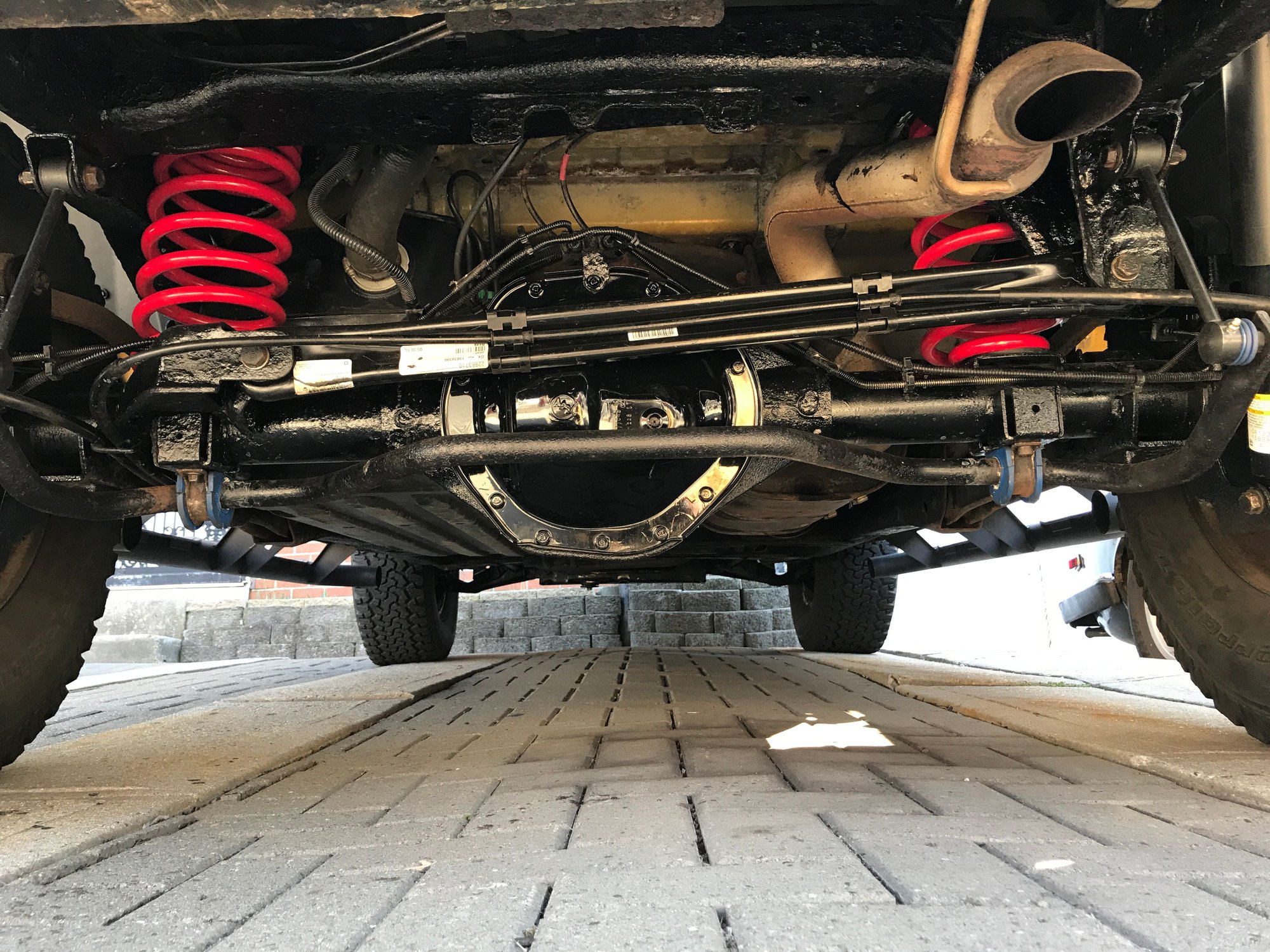

sounds pretty much like what i had to do. maybe rust likes yellow trucks more then other colors LOL...
before "cleanup"
i could have done a better job cleaning it up but its my daily driver.
After said "clean up"
before "cleanup"
What paint did you use?

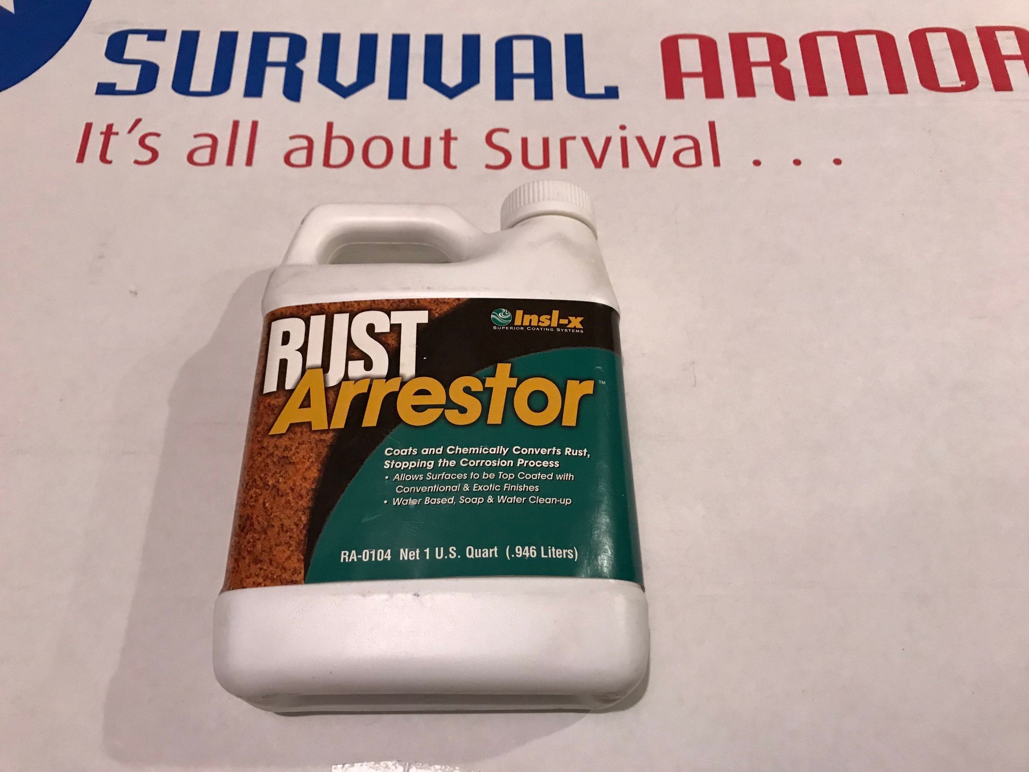

after knocking as much scale as i could stand i first treated it with a rust reformer then i used black industrial rust-oleum paint in a spray can. there was ALOT of scale.
what is the rust reformer product called that you used? can you link the products? I am planning to attempt this exact same restoration on my wifes escalade

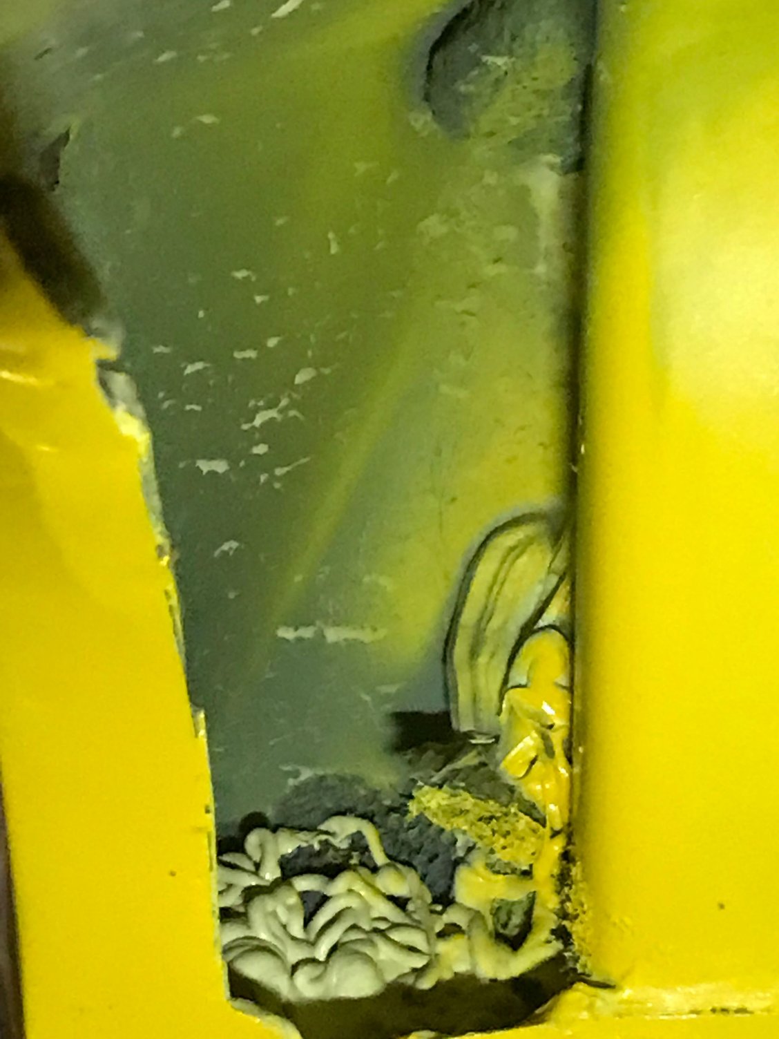

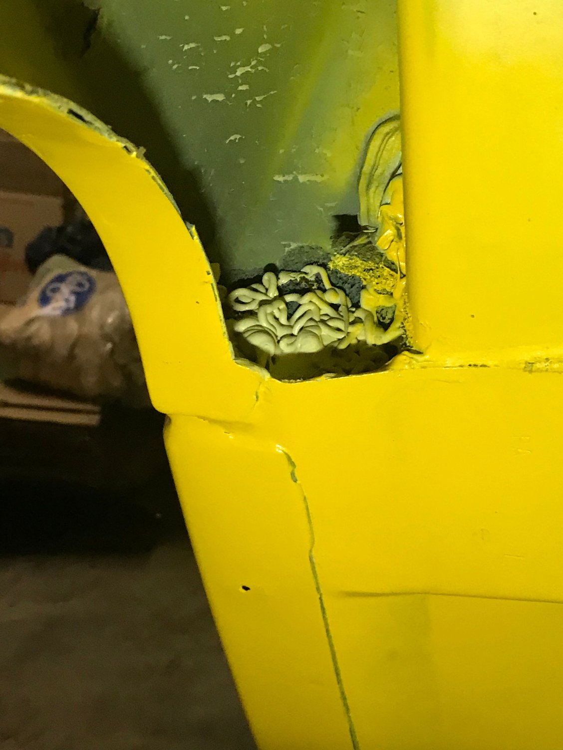

Alright I started to button things up. I still need to do the rear axle, pull the wheels and spot chk behind. And I need to put the trim back on, I also want to paint the front and rear bumpers... just to freshen them up. I have ran into a deli a though. I forgot the fabricator that fixed my panels pulled out some sponge like material in the wheel well. He says it’s ok as is but I feel like I need to fill it in. What do you guys think about me using that expanding foam to fill this area (same on both sides) and then shape it so it will not allow things to get caught in the hole. It’s hard to tell by the pic but if you remove the rear wheel well liners and look towards the rear doors you have this pocket and it’s topped off with a sponge like material that totally holds water. This is why I had rust in the quarters.

Or should I keep as is and put the wheel well liner in and move on. I may be over thinking this. I mean it’s how they designed it. So it may be ok. The wheel liner covers it up.
Thoughts?

the E-brake cable clips I pulled from a 2005 escalade. the rust reformer I used I got from a friend. I do not know where to get it.
Insl-X Rust Arrestor
back
side

Do NOT fill any body cavity with run of the mill expanding foam like great stuff unless you want it to rust out very quickly. The factory foams are very specialized closed cell formulations that are designed specifically not to trap any sort of moisture and have very specific densities and are a type that are designed to cure without moisture (basic foams actually need moisture to cure which also helps cause more rust).

also after thinking about it (see my pic above) I am going to put a little polyurethane in those cavities in the wheel well (just enough to cap it off. And then forget about them. May do that tomorrow.
