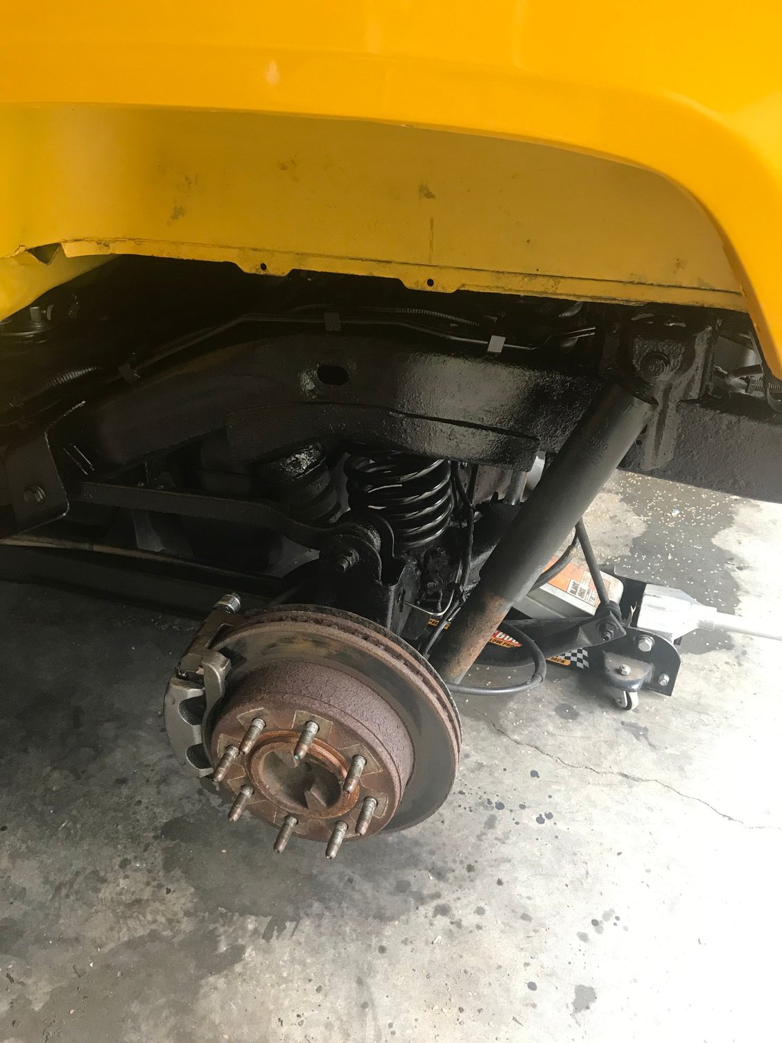

Alright I was able to press the studs in. Pain in the rear. I have the calipers and new pads on. Just need to bleed them out, which I may do tomorrow. Then I need to get some gas so I can start it up. I’ll still paint the bumpers and axle but it will be a few days till I can get to them. I was going to get a local shop to spray them for me but now since my money went to calipers... I’ll just get out some bedliner and spray them down... that will satisfy me till fall I guess. Here are a few pics I took yesterday before I put the trim and wheel well liners back on. It looks pretty good.

that's what mine look like
wow everything looks great. I wish my tow bar look that good. I still have to pull the rear bumper and do what you did. how hard was it to remove the rear bumper? is it as simple as unbolting the shackles?

I sincerely hope you are not crawling around under it with it just sitting in a jack and you have some jack stands to safely support it.
Aside from that it looks great! Nice job on getting that dealt with.

Yeah buddy, jack stands are there when I’m under it - lol I’m not interested in becoming a Hummer pancake these shots were just spur of the moment. I’ll have more once I can get it out of the garage.
I do do the same by the way. Lots of folks don’t think clearly when working on or under vehicles.
