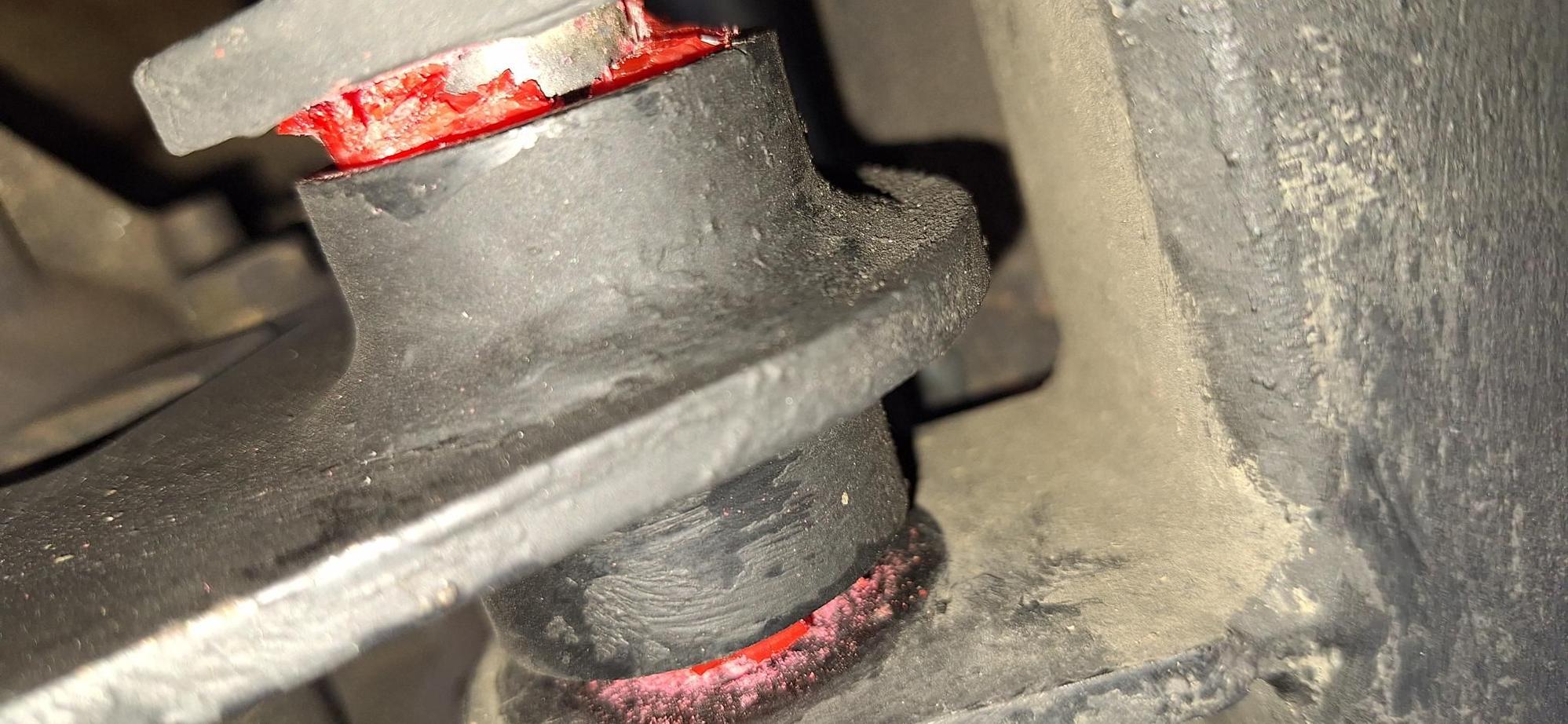

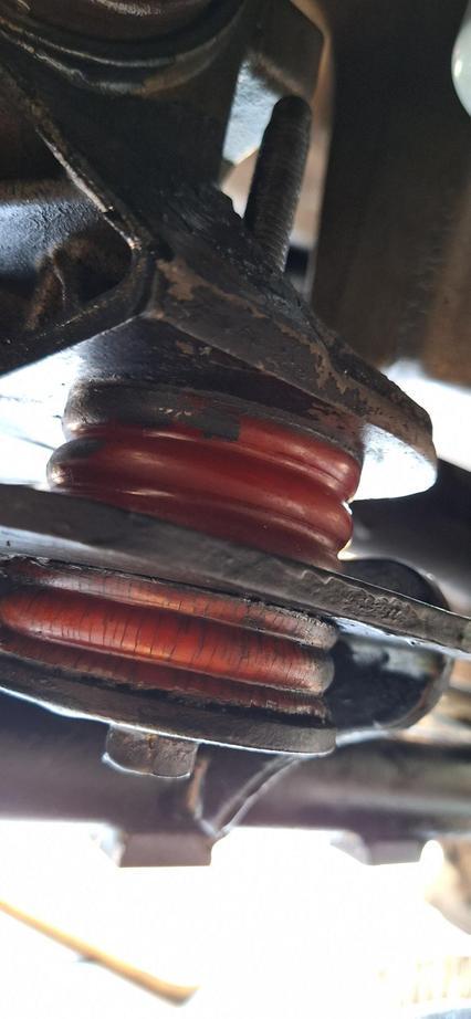

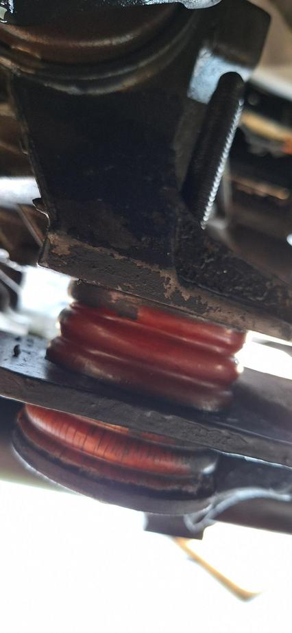

Question Ranco lift bushes H2
I have a 2004 H2 with a Ranco lift. The bushes in the front differential are non standard as you have to do some cutting when doing the lift. Two of the bushings are breaking up badly now. Ranco say they do not make them anymore and cannot help. Does anyone know when i might find these bushings so I can stay on the road.
Front bushing
Front bushing
Rear bushing
Rear bushing
Old Oct 2, 2025 | 03:20 PM
RobertDez's Avatar
Joined: Feb 2024
Posts: 549
From: Oregon
If you don't have a metal lathe, any machine shop should be able to make you some replacements out of aluminum. I used to make solid leaf spring shackle bushings on the lathe all the time. (The racing crowd prefers solid suspension bushings. Improves the handling. Not to mention they're a lot more durable)

Old Oct 3, 2025 | 08:06 AM
calif phil's Avatar
Posts: 2,317
From: Kansas
Another idea would be to check with someone like Energy Suspension and see if they have something similar, chances are they might have even made them for Rancho.

Old Oct 3, 2025 | 10:40 AM
RobertDez's Avatar
Joined: Feb 2024
Posts: 549
From: Oregon
That's another excellent idea if you don't want the solid bushings.... but I would go ahead and have two sets made, hasn't appears your lift kit really eats them up?

Old Oct 3, 2025 | 01:11 PM
Eddy Lee's Avatar
Joined: May 2019
Posts: 14
From: Panama
​​​​​​Yes it does. Also eats CV joints, I'm on my second set now!
