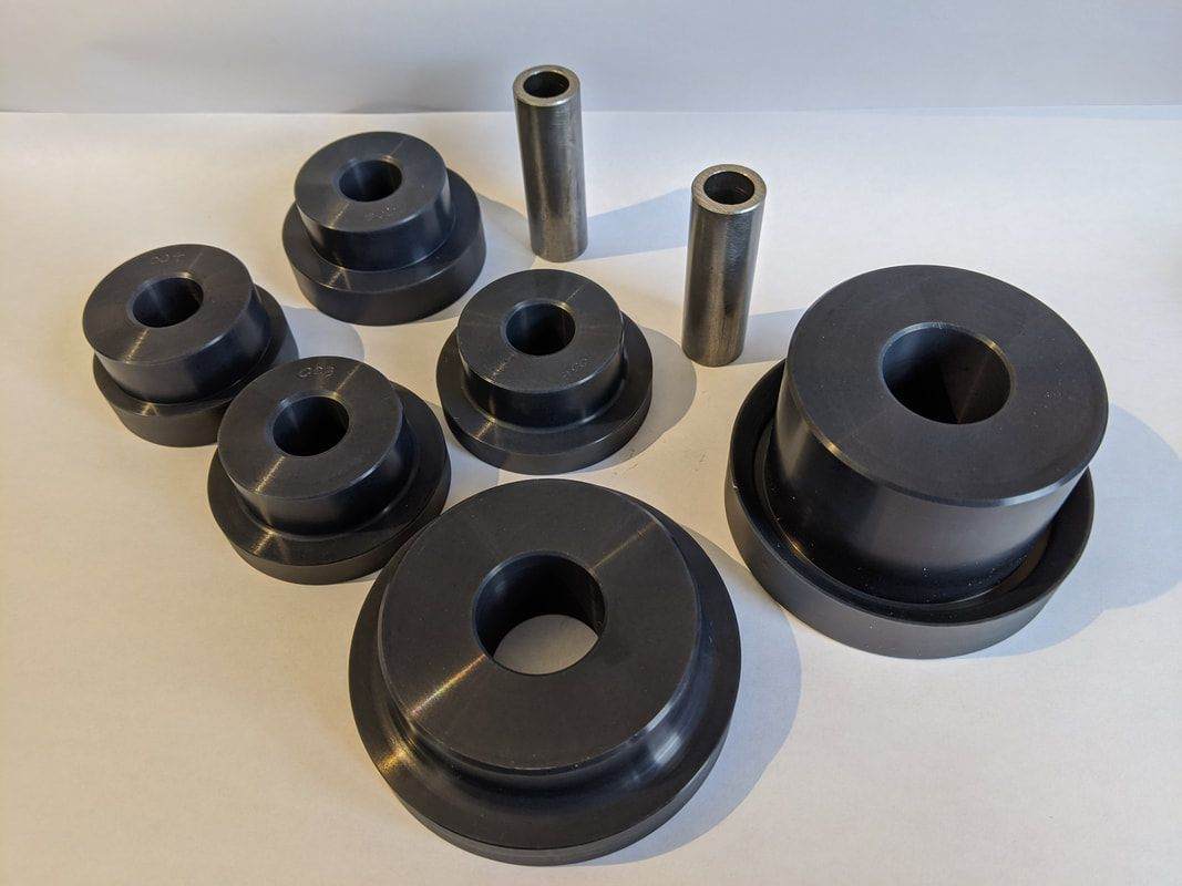

I did these recently in my '09: https://www.outfitterdesign.com/h2-f...shing-kit.html
Not sure I noticed a big difference between stock rubber and these.

Order a "Control Arm Bushing" which are easily obtainable. The item is too little but it will slide in the hole where the correct bushing is suppose to go. Then tack it in once on each side of control arm bushing. This what I had to do just today. Unless there is another chassis out there that replicates the Hummer H2, it will be dang near impossible to locate. Don't know why GM quit making these bushings. Also, be dang careful about scam artist websites that say they have "kits" to replace bushings for around $550 and they are made out of some type of polymer material. It's a bunch of bull crap. jsIII
