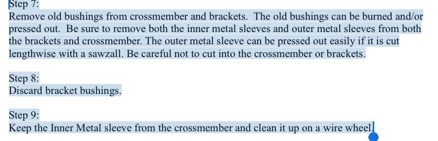

Interesting, the install procedure for the kit looks complicated for the crossmember bushing:
Is it not a straightforward press out and press in with ‘normal’ bushings?

Yes, the OD instructions are a bit crazy, overkill, and not clear. The product looks top-notch, though. Keep in mind the OD kit is not a press-fit bushing.
You shouldn't have any issues pressing out/in the bushing with a shop press.
