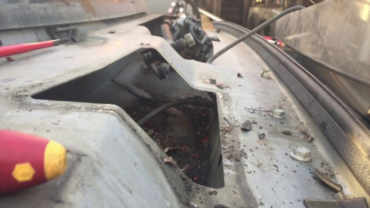

in your picture with the tarp it looks like the passenger side wiper cowl is able to allow water into the cowl area. right under that part of the cowl there is a access panel that covers the A/C air box inlet /blower motor. sometimes that cover gets detached and allows water to come in through to the inside of the truck.
was it the front passenger foot well side that was wet?

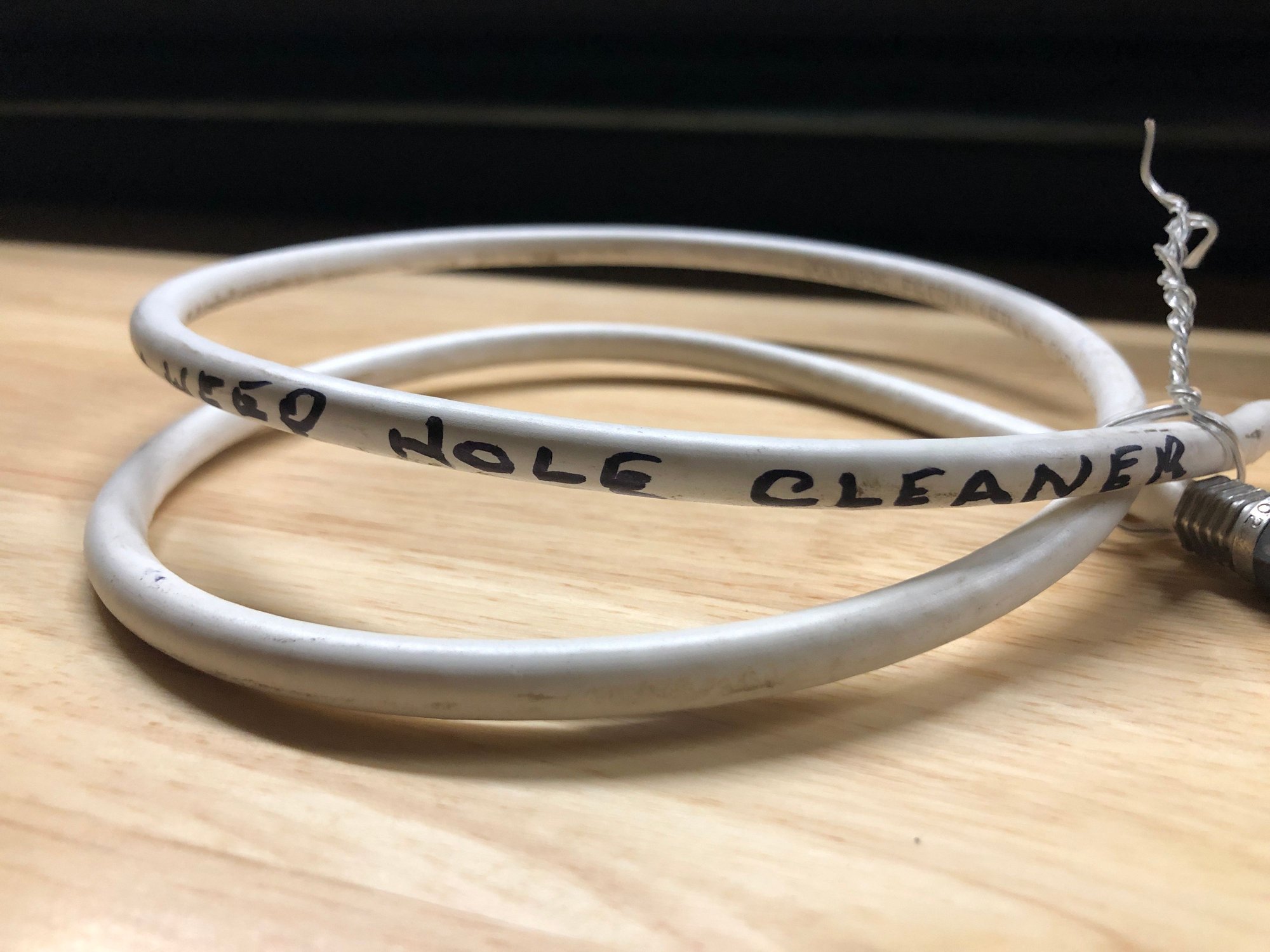

Lightbulb Weep Hole Cleaner & Running Light Leak Workarounds
2005 Hummer H2 with Sunroof
152k miles
Recently ran into an issue with water leaking in from the roof. True source was unclear as weep holes were clogged on both side and running light gaskets thickness appeared to be insufficient to seal with the roof.
Tested both of these for an hour running hose and sprayer to the top of the truck; no leak after doing these!
Solution for weep whole cleaning quickly:
- Find some old Coax TV cable and cut 6 to 7 feet from it. (example picture below)
- Used used CATV 18 AWG cable and left the coax connector on the end to make easier to grip
- The cable fit into the weep holes perfectly. (got the idea from a Sonic Straw that fit into the hole and was the same diameter as the coax cable)
- Was able to run it all the way through and clean out the weep holes in about 5 minutes
Solution for water leaking in through running lights:
- Ordered another set of gaskets for the running lights (full set for all 10 running lights)
- Link for gaskets used:
Amazon Amazon
- Doubled up the gaskets by carefully aligning the new ones to adhere to the bottom of the existing ones.
- Note: The existing running lights & gaskets were about 3 years old. Had replaced them.
- Re-installed the lights
- Did have to carve out 1-2 mm on some lights on the non-sprint loaded side to get them to lock into place
Hope this helps someone who may run into the all to common water leaking in problem.
