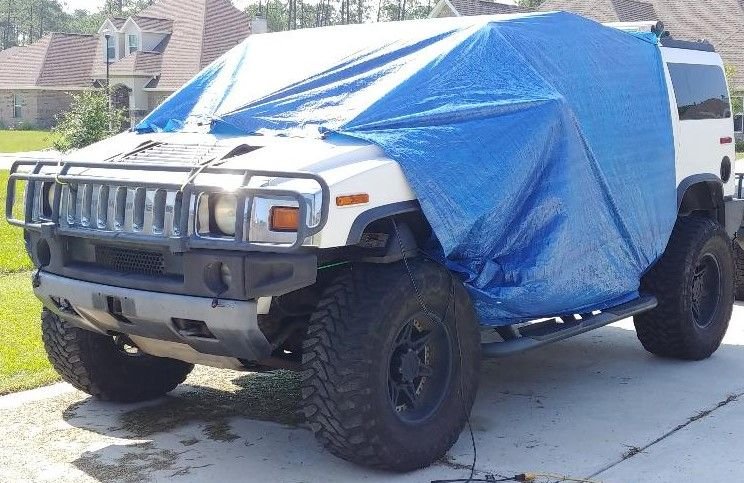

Hey all, I have had the same issues. So I started pulling the interior apart to try to find the leak, and decided that while it is apart I was tired of mopping up the water that collects under the door sills. So I covered the cab with a tarp.... it was doubled over and fasten down tightly with bungee straps. (see picture)
It looked like it would be really difficult for any water to find its way into the truck after this....
Well after a good southern rain storm.... I come out to check if we had success.....
NOPE!
The tarp didnt keep the water out.
So I am wondering if anyone has any ideas where this water is coming from...
Thanks for any help

The roof is fairly flat and its is not sitting on a hill so the tarp is not going to help unless it is big enough to cover the entire roof as water will just run forward as well as back from the entire back half of the roof that is not covered. Many get some from the outer seal above the doors which continues from above the rear doors to the front and then down.
