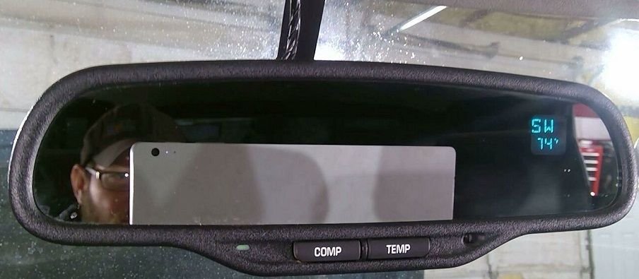

I know I'm posting to an old thread, but what the heck... Last week my mirror's compass/temp has all the LED segments on. Similar to this picture. Obviously it has power so I'm assuming some internal failure.
Although I'm almost sure it looks like this when the truck is started and then goes into normal display mode.
Is there an easy replacement?
Compass isn't really any big deal but I always look at the temp.
Thanks!

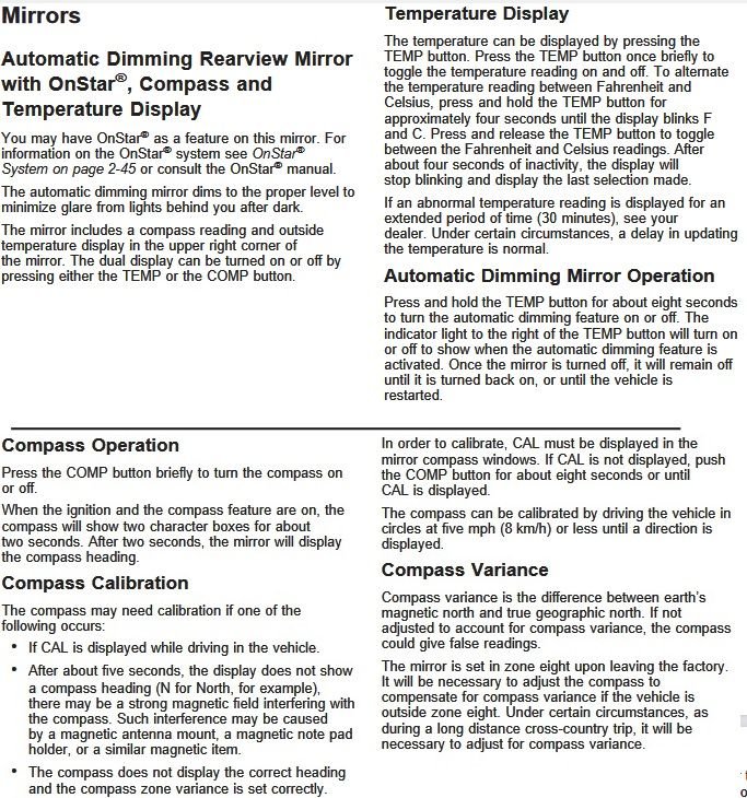

It's not easy finding data on the inside rearview mirror internals and personally never seen one up close.
I found
about GM Compass Mirrors, its not the same, but the H2 mirror may be similar and it might provide a clue as to what could be wrong.
