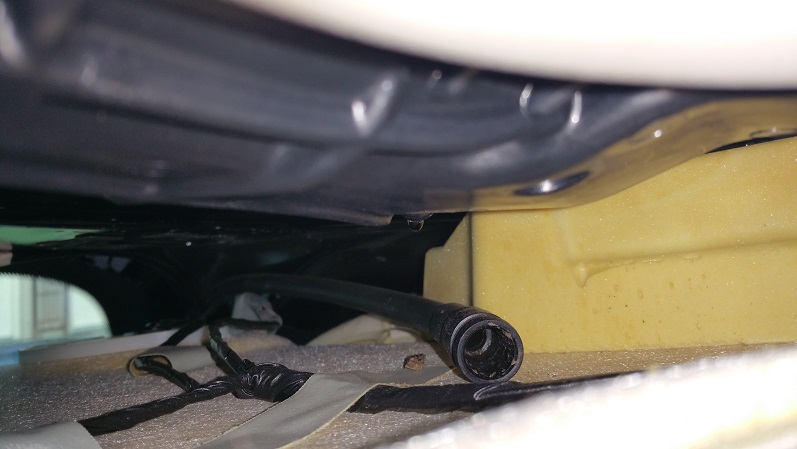

I removed both A-pillars & unhooked the oh crap bar by the passenger side.
I was able to pull the head liner away enough to get a look & see what was up.
Here's a shot of the passenger side. The tube wasn't even connected! Water was draining into the head liner & through the open/close button for the moon roof! I connected it & knock on wood, it doesn't leak now. I will zip tie it before putting everything back together.

The driver's side is attached, but still leaks. I'll pull it & see what the problem is tomorrow while I still have day light.

All I can say is that passenger side tube is a beeeyotch to put back!! Punch out the flappers to prevent future clogging. Mine have been good since doing this mod and we get some of the worst rain in the country living on a tropical island. Good luck.

Once you get a lot of the trim out of the way, getting the tube attached on the passenger side is fine. I had to also reattach the driver's side. That was just a hair more difficult, mostly because I'm right handed. So far, so good. I have no leaks after testing w/ the hose.
I have to cut out the flaps. I have yet to to do that. That's another deal for another day. They aren't clogged, so at least I'm ok for now & we get enough rain here that dust isn't much of an issue.

After removing the ceiling liner back to the B pillar, I was able to reach up & around to attach the passenger side & monkey with the driver's side tube until it sealed corrected. Everything went back & looks like I didn't touch anything.
No leaks so far!
