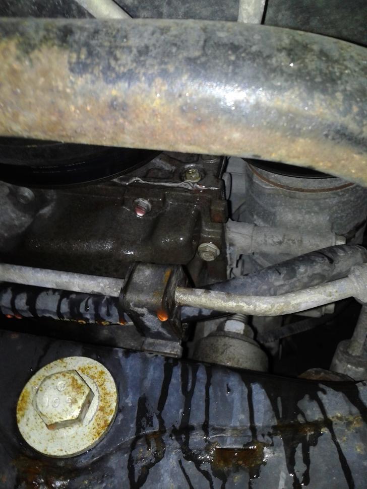

I have a '06 H3 with a leak that I am stumped on. It started leaking a month ago, but this was a very small leak that was not even leaving drops under the truck. I think it was burning on the engine as there was a slight smell of antifreeze when we would get out of the truck. I was trying to locate the leak but couldn't find it and it was leaking maybe a quart over the 4 week period until now.......it is leaking constantly and it’s dripping quite substantially. I checked from under the hood and can't find the problem and from under the truck I can't tell either. One thing that I do know is that wherever the leak is it is dripping on the serpentine belt.

Possibly water pump weep hole?

crack on top of your radiator
Old Mar 24, 2012 | 11:20 PM
Best guess is the rad is cracked where the plastic top meets the metal portion of the rad.

If its the radiator how would I go about checking it? How about if its the weep hole? I really need to figure this out soon otherwise I'm taking it in to the dealer which I'd rather not do if I don't have to.

if i were there to look id get it hot,let it sit idling,open the hood and look at it for 32 minutes.
i dont know what to say beyond that

I've done all that and still can't tell, well maybe not for 32 minutes! Dealer time tomorrow, I'll have to wait and see. Thanks for the suggestions.

It looks like somone may have worked on it before I see some kind of RTV sealant on the radiator.
Have a shop do a pressure leak test

:stupid: I had the same issue with burnt coolant smell but no was show underneath or on the engine. So went to my local shop and did a pressure test and yup leak in radiator..
