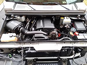

Originally Posted by Cuz
I really havent tore into how to install the trans cooler yet. What do you do with the lines going into the radiator. I see the 2 lines going into the cooler but doesnt that still leave lines in the radiator.<br />Im asking this because mine just took a dump i think. Coolant in the transmission. Does that mean i need a new radiator as well.<br />So you just connect the external cooler to the lines going into the radiator then plug all the lines in the radiator.
Hey Cuz, The radiator is shot.
When you install the new rad leave the plastic plugs in the inlet and outlet underneath the rad where the transmission lines supposed go.
''Get the transmission oil cooler I listed''
. I'll try to post more pictures of my hook up if I could find them.
Im thinking if it's possible to purge the old oil out the transmission before installing the new cooler.... Just a thought,,,,what if you cut the trans lines going to the busted rad and connect them both with a hose and clamps then do a total trans flush. You want to get the mother load of transmission oil from the thorn converter out.. Or call a transmission shop for help.
Attached Thumbnails High Trans Temp 190 F-img_0385.jpg   High Trans Temp 190 F-img_0396.jpg   High Trans Temp 190 F-img_0410.jpg   High Trans Temp 190 F-img_0414.jpg   High Trans Temp 190 F-img_0441.jpg

yeah i have it all torn down. Just ha e to order the trans cooler. Kind of figured it all out once i tore it down. Looks more i might be able to save the tranny. Not 100 percent sure yet until i check it more.
