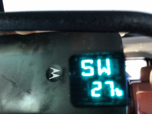

I got the ''TRANSMISSION HOSE'' today so I'll be installing the new 3/8'' lines and the compression fittings tomorrow.
If it looks like the transmission is not heating up enough during winter I'll have to re install that REMOTE THERMAL BYPASS.
Old Jul 16, 2015 | 04:49 PM
  #28
man-of-war's Avatar
Joined: Feb 2013
Posts: 102
From: Ontario,Canada
The transmission is running much cooler,It's in the 145F range.
